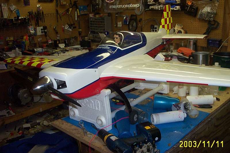

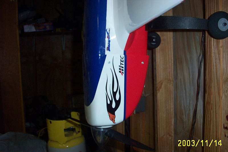

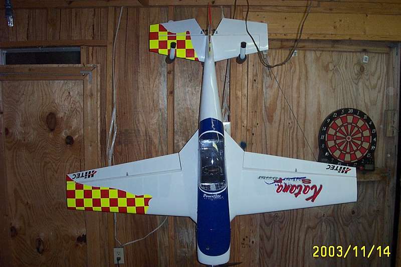

Default RE: OS 160 Problems please help
here is a pic
