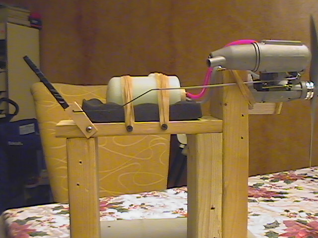

I made mine from MDF, and screwed and glued it together. Clamped to a saw horse. Very simple. Built from scrap. Have run 3 engines in on it with no problems at all.

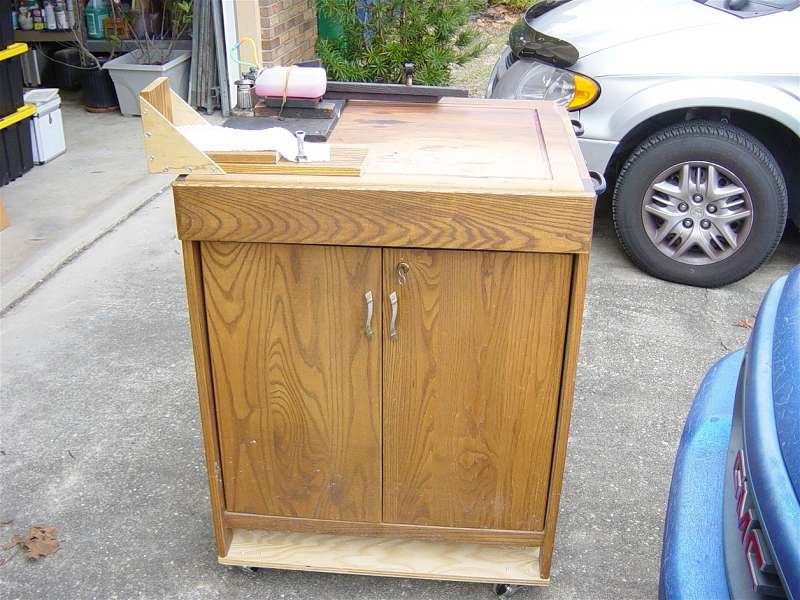

Old 01-15-2004 | 05:07 PM
Ed_Moorman's Avatar
Posts: 4,059
From: Shalimar, FL
Default RE: engine run up stand

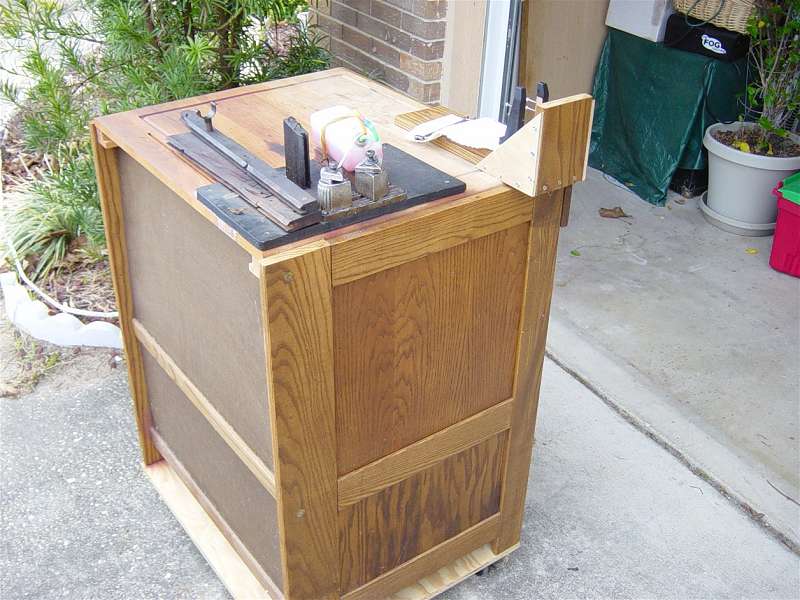

My present engine test stand, which I made a year or so ago, was made from an old microwave cabinet my wife didn't want any more. It replaced a 2x4 with a 5/8 ply top I had been using.
You can see the new one has a cabinet and a drawer, that come in handy during testing and break-in. The cabinet holds all my engines and associated equipment. The drawer has long tuned pipes and holds tools, my tach and other items I may need during the test.
The test stand has lockable, swivel casters (beats putting a concrete block on my old table to keep a big Moki or gasser from turning it over) and it has handles to help move it.
I have my smaller, glow engine mount on one side and a presently unused large engine mount on the other. The well used pipe mount (looks black) swivels in and out to accomodate different size headers and engines.

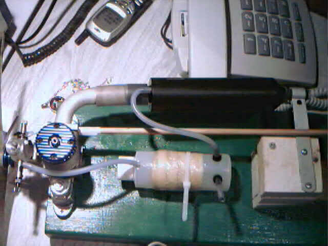

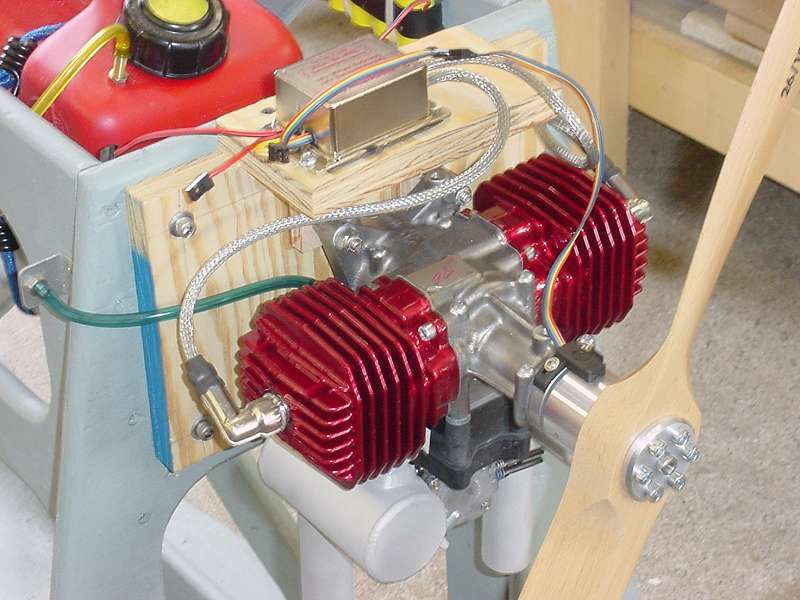

here is mine

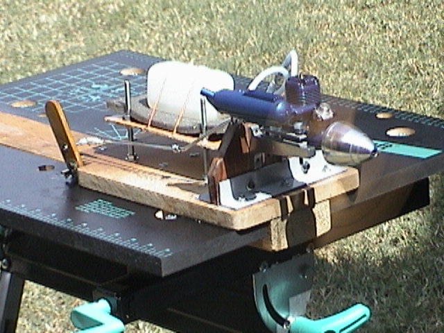

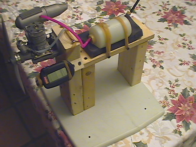

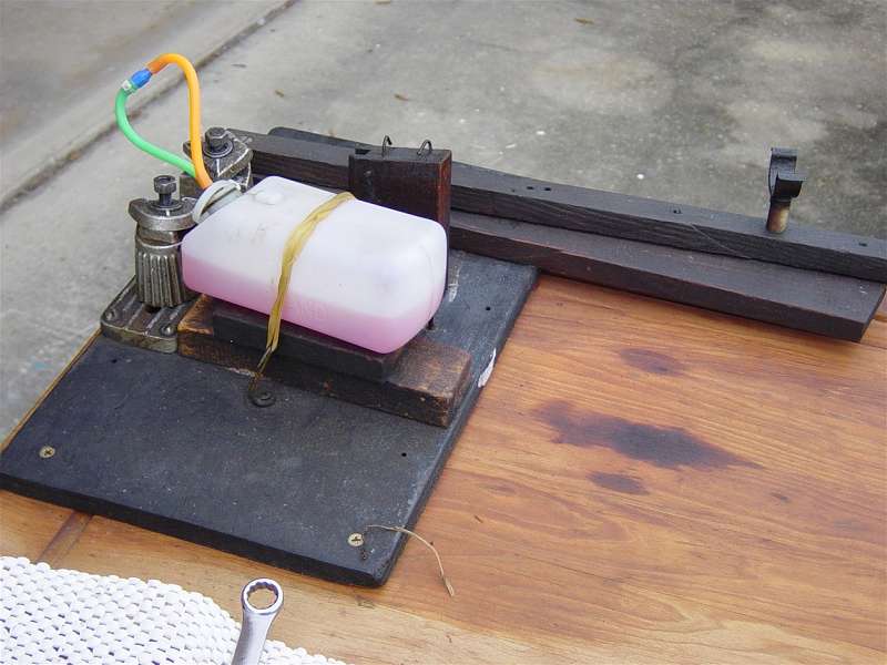

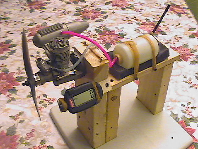

I simply cut a "U" of appropriate size in the end of a piece of plank and drill to match the mounting screws. I have a tank that I mount with rubber bands. I screw the whole thing down to a sawhorse with deck screws. It only takes a few minutes to make the mount. I have accumulated one for all my engines. The picture shows several. I move the "throttle arm to the mount I'm using. Simple, cheap and effective.

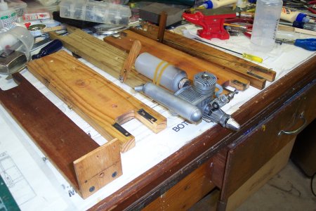

I too tend to do the U cutout in a piece of 1/4" or 1/2" ply and quickly attach it to a spare sawhorse with drywall screws using a battery drill. A horizontal screw each side with a wing-retaining rubber band holds down the tank sitting on a bit of foam to isolate it from vibration and another long screw with a small rubber band wrapped around it a few times grips the throttle rod behind the engine.

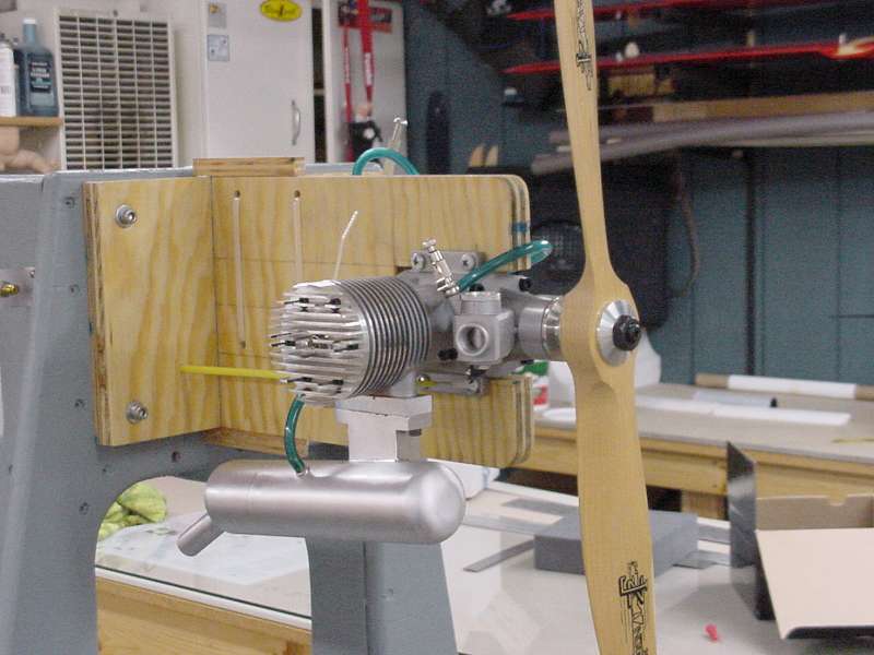

Here's a QS-106 at 7000rpm. I copied this stand from a photo from RC Showcase. Its held up to several 150's with "O" issues. With each motor I make up a new plywood plate which attaches to the front. Its the best stand I have come across. Walt

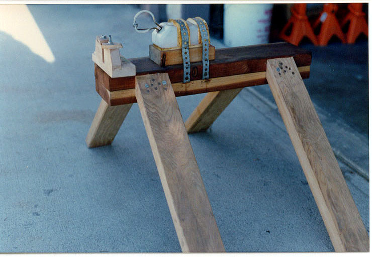

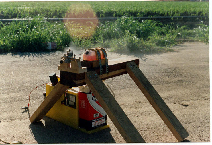

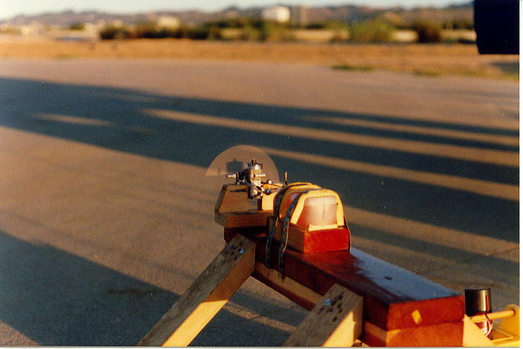

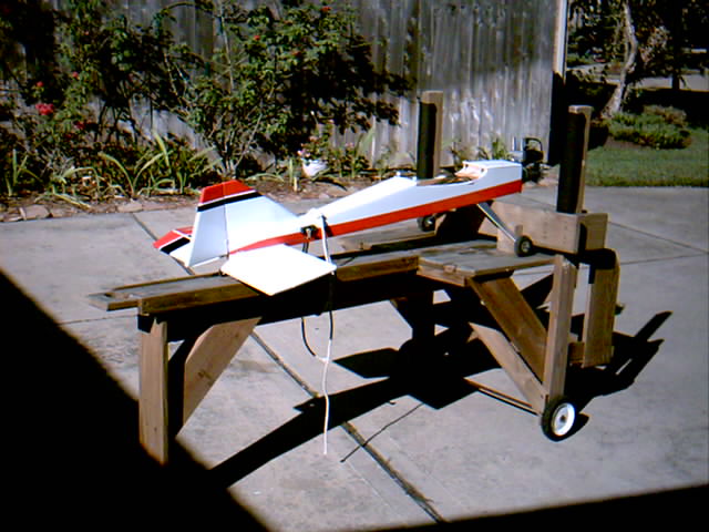

Here is my test stand I built 20 years ago. I just had to throw it away because the wood finally got rotted after sitting outside. I'll be making another but with a PSP Mfg engine plate.
