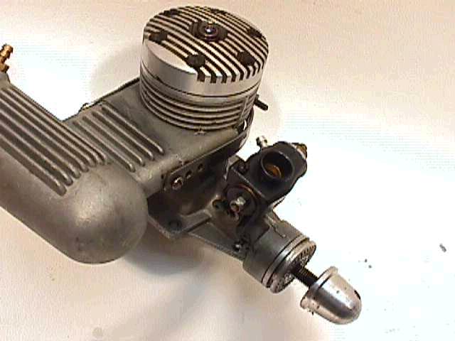

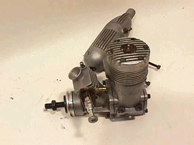

Thanks for the fast response. I don't suppose a pic or 2 would hurt. I'll try to post em incase it this aids in any more advice. BTW if anyone can help me nail down exactly which engine it is I'd appriceate that.

I'm sure someone will know the exact model number but it's a cross flow (loop scavenged, call it what you will, but non Schneurle ported) engine and uses a Dykes ring. This type of ring relies on combustion pressure to give a good seal so they always feel worn out when turned over by hand and can even be difficult to hand start sometimes. Once running though, this type of ring is very effective.

It appears to be a model 4011 from the early 90s. Earlier models used a different carb and later ones had a remote needle. The explaination of the dykes ring is correct. Put it on a bench and test it. It should turn between 11,800-12,800 with a 10x6 prop. Not a powerhouse but a good reliable engine with a solid history.

That's the very early model 4011. Mine had/have the smooth face carb before they switched to Perry carbs. downunder is correct that they have to be flipped fast in order to feel any good compression. Only sure way to start it is with the electric starter and an idle bar plug.

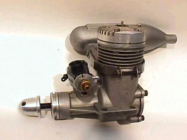

Dar Zeelon I wish that I could get another pic of the engine. Unfortunately my new computer and my old camera don't seem to be getting along. I got those 2 pics from the auction where I bought the engine. The number stamped into the mounting lug is 0069241 if that helps. If your looking at the engine with the prop shaft pointing at you theres a small screw at the 10 o'clock position other then that the only other components on the carb are the throttle, needle valve and where the fuel line hooks up. hope this description helps. Thanks guys I really enjoy all the info. I'll just have to crank this baby up and see how she does.
Oh and one more thing I got this K&B 61 also. Seems to be fine can't wait to put these in planes
Brandon

The first pictures you posted were from about 1987 or 1998, with the K&B carb and direct needle mounting. If it had the remote needle then the date would in the early 90s to current. The later post shows the same type 4011 engine in an earlier version, around the early to mid 80s, with the Perry carb.
All your illustrations are the type 4011, which is a current engine, and except for carb differences they are all the same.

Your .061 was designed by Clarence Lee even before K&B owned the design. Yours is an early example with the perry carb. They later had some with an irvine carb then the K&B Block carb then the finned carb as on your .40 then the finned with remote needle. The current incarnation of this engine is still in production although probably not for long. It was announced that the twister will be discontinued and a new conventional head ABC .61 will be introduced.
These engines are very powerful for and engine in the .40-.46 weight class. Their power is very low for the .60 size class but since they are light and run so reliably they have been well accepted for a long time.
By the way: This engine also was involved in a crash or similar event as the muffler should bolt on not strap on.
