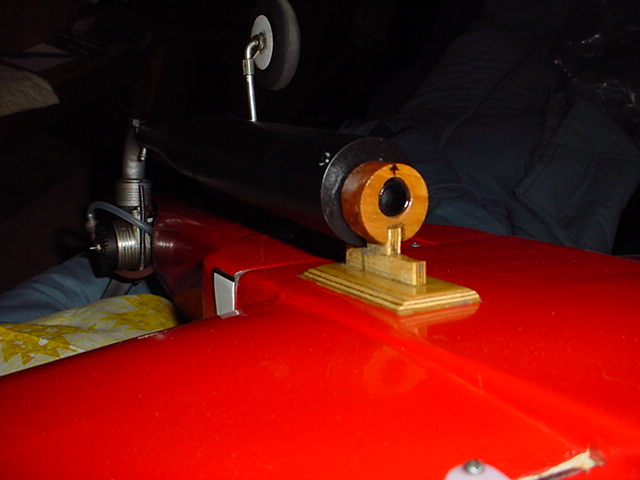

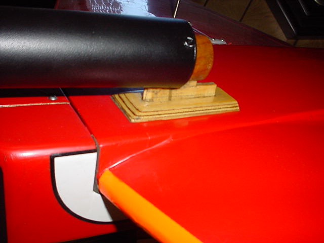

I tried one of those "zip tie" mounts....it lasted about one minute.
If all else fails....you can make one for nothing....this one has lasted
for 2 years....still going. Glue it up on the fuse where the pipe
lines up good. To remove the pipe, you have to take off the header,
the pipe comes off in one piece....
Dave.

Dave,
I wonder why your zip tie mount failed so quickly? I run these mounts even in belly pans were cooling isn't as good as an external mount and never had one fail. The foam pad tends to melt over time, but pulling the zip tie one more notch tightens it back up.
John

Don't know, John....I put one on a Sport Fly 40L a few years ago, with
an K&B .61 on it....with the pipe. After about a minute of flight the engine
was sagging a bit....so I brought her back in to readjust the carb. It was a
maiden flight on the plane, and a rebuilt motor.
When I got it in....the zip tie was already gone, and the pipe was only
holding on by the rubber joiner. I couldn't fly the plane any more that
day....and always remembered that plastic mount that failed....[X(]
Maybe it was defective....or I pulled it too tight....or whatever....but I
never tried another one....
Dave.
