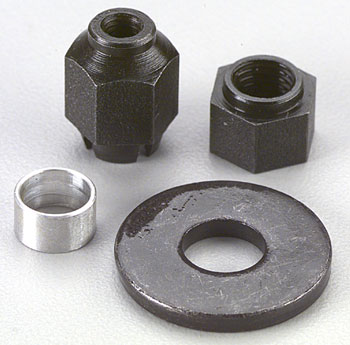

great planes makes spinner adapter kits, i found them at my lhs. it replaces the stock set with a locking set that has the spinner adapter. http://www.greatplanes.com/accys/gpmq4550.html
look at the adapters under the spinners.

part# GPMQ4588 Adapter Kit-O.S. FS70-120; 140RX is 5/16 -24

here is a picture of the great planes locknut with spinner adapter built in.
