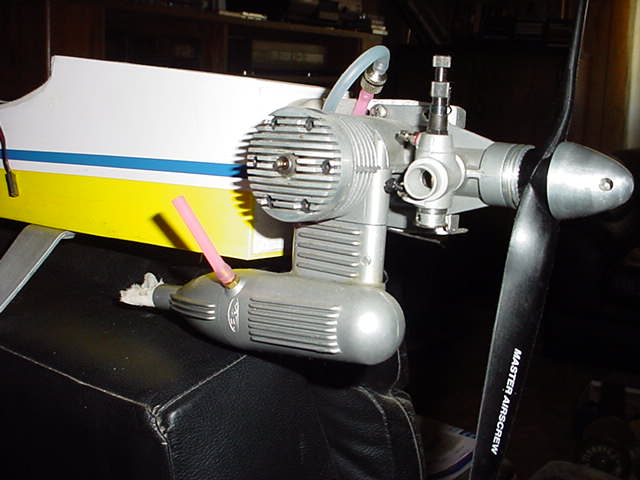

] I have a K&B 61 that is giving me fits on low idle... It has old perry carb and we dont seem to be able to keep it running. When we lift plane up , engine seems to starve and die..... Is there proper settings that anyone can help me with ? I am a newby and would like any help given..... ?

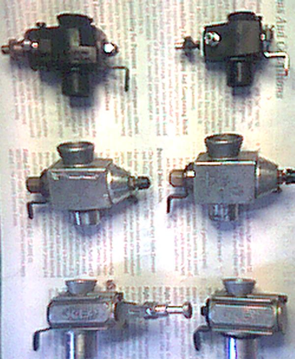

First, is your engine's carb a pumper or a suction version? Look at the first picture attached, if your carb has the extra screw like the one on the left it will not work satisfactorily without a pump. Wont even work with the Iron Bay or Cline pressure system, it requires a pump. Look at the second picture, the pumper is the top left, normally aspirated carb is top right. Might see the difference more clearly here.
Assuming you have the right carb the idle slit could be clogged with congealed oil, or its o-rings could have failed.
Take the carb off the engine, unscrew the needle and set it aside. Remove the circlip from the side, and the idle stop screw. Pull the throttle barrel out. Now pry the mixture disc out of the carb body.
Look at the third picture. The part shown is the K&B adaptation of the Perry, yoursw is not quite the same. You can see the hole on the side of the tubular extension, this is the idle slit that clogs. On your carb the slit is in the land between the two o-rings. Clean it with a small bit of typing paper wetted with acetone, don't use anything but paper - the size is critical and can be damaged. If there is any damage to the o-rings order a new set from Conley Precision or MECoA, they're not expensive.
Reassemble, adjust, and enjoy.

Thanks for the help.... I was thinking about ordering a new carb from Tower. I purchased this engine off of E Bay and when it got here, we found that the carb had been jb welded to the engine. Another flyer gave me another carb and this is the one we are trying.... Also the one from e bay had the needle valve glued into the housing. I am considering purchasing another carb that is new. The problem is Tower wants $35.00 and Mecoa wants $45.00 but I can purchase a new engine with my engine for trade in at $80.00 from Mecoa. I guess I just have to figure out what is best for me and the most trouble free. Lack of knowledge is a terrible thing........ Both of you gentlemen were very helpful....
