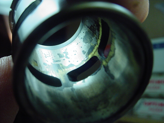

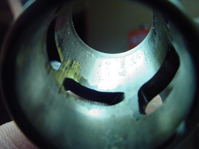

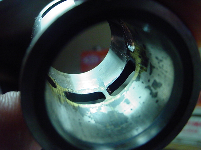

My Feedback: (21)
It looks like this....total disaster ! [X(]
This is a .61 Rf (rear pipe) pattern engine....real nice engine, with a real cheap
liner....which as you can see....took a dump. OS stated that they didn't have
any problems with this engine either, and the cost of a new piston and liner
was around $115.00. [sm=stupid.gif]
