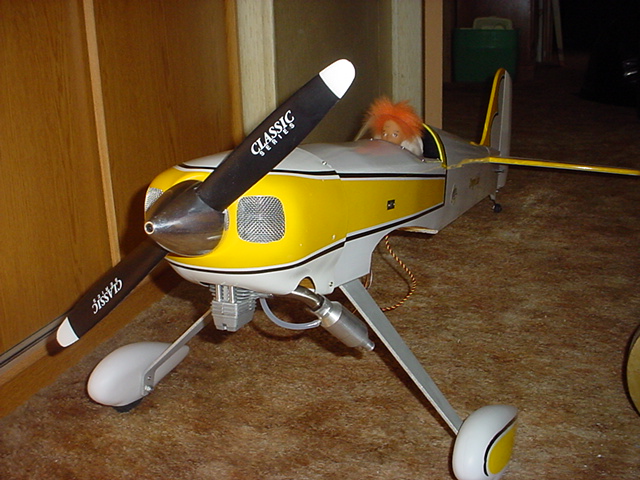

I have a Dragon Lady too....with a Magnum 1.20 mounted inverted. I really
like the plane. [sm=thumbup.gif]
