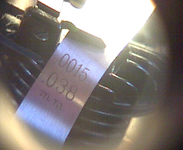

And while I would not object to 0.003mm cold clearance, I am sure, as BSC said, either you were told 0.003" or what was meant was 0.03mm. Just a hair tighter than the 0.04 stated minimum. If you use a feeler strip of 0.0015" you'll come out fine. That is 0.038mm, and you wont get it any closer.

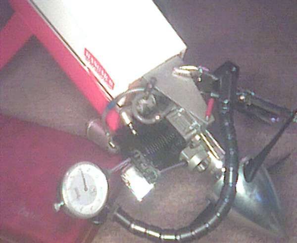

Another car racer. My goodness. Then you know that after the rockers wear a little bit the feeler clearance is less than the real clearance. And the only accurate way to set valves is with a dial gauge. And that rocker wear is why I say to use the 0.0015" thickness, if you insist on using a feeler.
I have not used a feeler on a push rod engine for a very long time, except for instruction or demonstration. I have a P&G Valve Gapper that has served me admirably for more than 40 years now.
