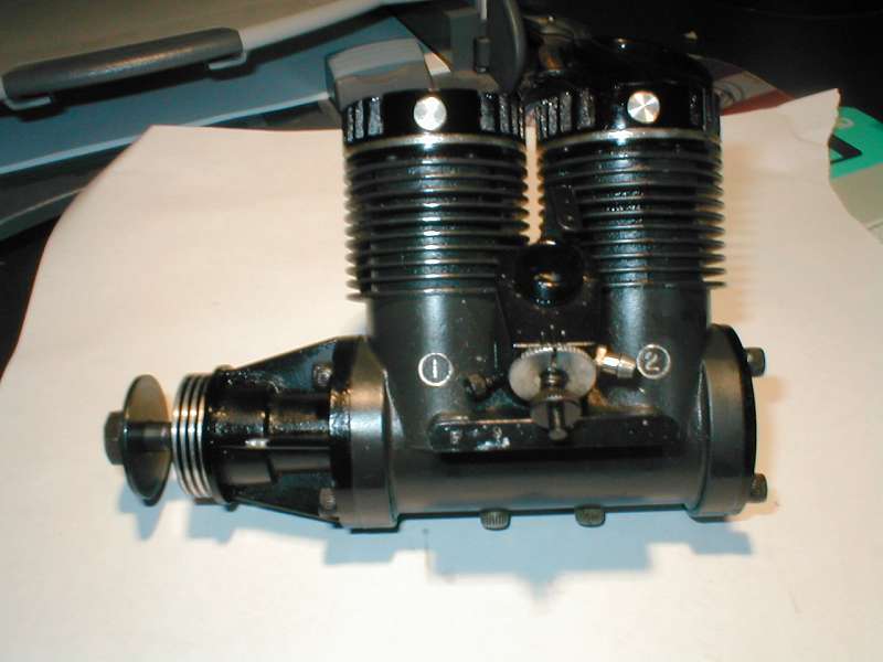

Old 05-05-2004 | 01:01 PM
My Feedback: (70)
Joined: Sep 2003
Posts: 27
From: Sandy Hook, CT
Default RE: why?
How about this???

Old 05-05-2004 | 08:33 PM
Joined: Apr 2004
Posts: 176
From: halifax, NS, CANADA
Default RE: why?
what make is this?
Old 05-06-2004 | 12:37 PM
My Feedback: (70)
Joined: Sep 2003
Posts: 27
Default RE: why?
The twin in my picture is a Ross .60, probably about 25 or 30 years old. I have had it almost as long, I got it from the original owner who could not get it to run satisfactory. I never really did anything with it until last year when the picture was taken. It ran great for me on Byron Super 18 fuel, Zingali 11X7.75 prop and OS #8 plugs. Very smooth, nice low idle, and remarkably quiet considering the exhaust is just hollow square stock. I ran it for probably 30 minutes or so and it never quit once, although the #2 cylinder would flame out if it idled more than 4 or 5 minutes. It also seemed to run quite cool, considering I did not add extra oil to the mix.
