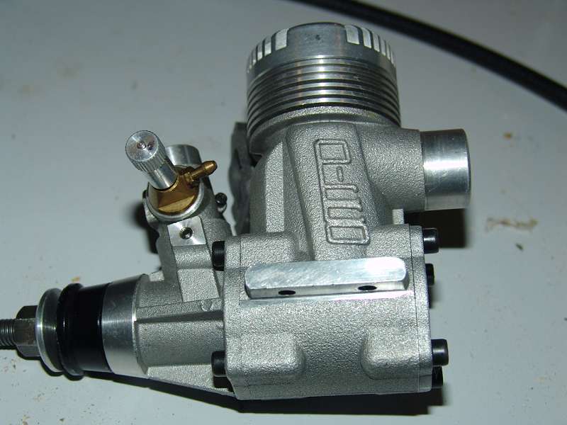

Hi,
Has anyone got any experience with Picco engines... 45, 60, and 80 (and p-80). Information seems hard to come by on them. How do they compare to Rossi motors and what are the slide type carbs like that most of them come with. Any input would be appreciated.
Mark and Karen

Mark, Karen,
I have a Picco 10 cc FISE engine, similar to the bottom photo, but with a black anodized head.
I have not run it yet, but they say it makes power similar to Rossi and to OPS, on 11x7.5-11x8 props, with the included black pipe.
The carburettor is made by HB and has a black, plastic body, attached with a thin wall, split bushing to the crankcase.
Your engine has a metal unit.
Did they make different versions of this engine?

Hi,
We too have a 10cc with the black cylinder head but with the metal slide carb.... perhaps the black carb model is a newer version. We have yet to run any of the motors pictured ... the best way to find out how they go is to bolt one into something perhaps??

We have basically grown up with OS motors, and up until the last 12 months the Italian motors (apart from Super tigre) were pretty much unseen. We ran x-serie Super Tigres with impressive performance. BUT....we are now converted.... have started playing with Rossi motors (60's).... what have we been missing all these years. We are hoping the Picco motors will go as strong as the Rossi's. OS fit, finish, durability is great..... but they don' t go like these italian motors.
We plan to use the FISE Picco RC-80, in the very top photo, in an EMS Freestyle Adrenaline ARF and were kinda trying to work out if it were suitable before buying the plane .

Picco's are fine engines, and powerfull. I have had all of the models you have pictured, plus some .40's. I still have the Picco P-80 fan engine fitted with an RPM rod (no longer in production..) I just recently sold (2) NIB FISE Picco .60 and FISE Picco .80, all with Picco headers and Picco tuned pipes. One of the .60's had an HB carb, the other .60 and the .80 had slide carbs.
Do a search for Picco in the pattern Forum..seems like a couple of guys have put the .80 in a pattern plane to give it a little more power now that the 10cc rule no longer matters.

Hi Again, and thanks guys for the information. "ChuckAuger".. the motor in the second photo is a P-80 and by its configuration we guess it would be a fan motor. It has a midrange mixture (adjustable spraybar assembly position) and top end (of course) but no idle adjustment, and is a barrel type carb. Is this motor suitable for prop use or is it suitable only for a fan.
Is there much difference in horsepower between the RC 80 and the RC60 or 65.?
Do Skyward engines have a website?? Any Piccos out there for Sale???

The P-80 fan engine, while designed for fan use, is destined for a prop. It will have to be a smaller prop than what you would want on a pattern plane to take advantage of the timing of the fan engine. I think any of the other .60~.80 engines you have would be better for pattern use.
And don't get bogged down in a bunch of number-crunching mumbo-jumbo. Just look at the .80 as a really strong .60. Prop it just a little heavier than you would a normal .60 (try to keep the tip speed in check), and go have some fun with what will be a much more peppy plane.
