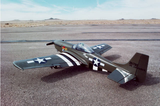

Yeh, what they said but i also have my own theory on this which so far has been very effective on this Mustang. A fair amount of Pilots leave their fuels tanks in the original position when inverting the 2 stroke.
* Doing this makes things worse. Turning the engine upside down now puts the carb alot lower than the tank therefore increasing a possible siphoning effect.
* If your going to invert your engine, lower your tank to help out.
I am running an OS 1.08 inverted in this P-51 with the fuel tank considerably lower to match and absolutely no problems.
