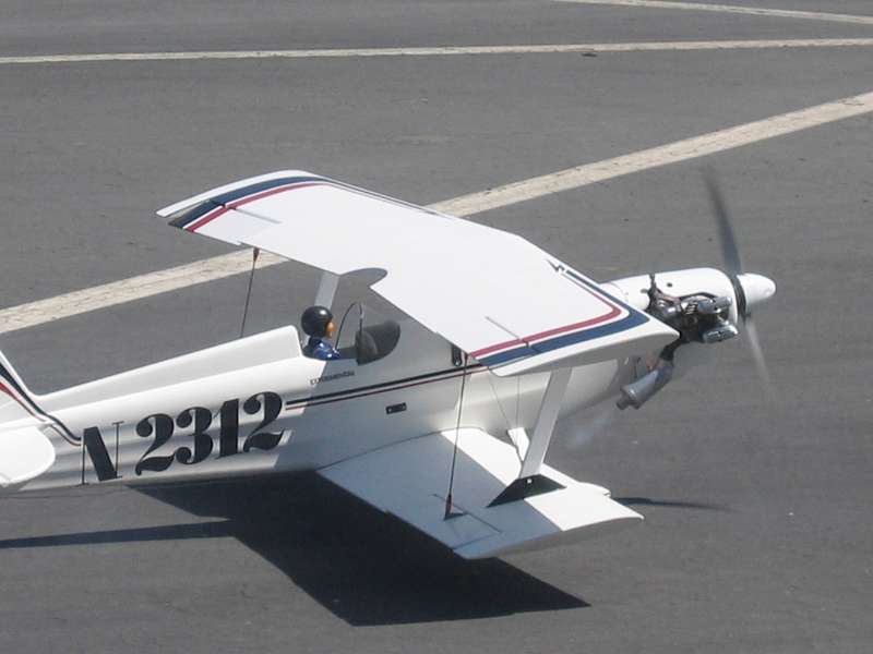

Old 08-04-2004 | 12:24 AM
My Feedback: (15)
Posts: 60
From: Poway, CA
Default RE: engine for bipe?
David74,
I used listeKote paint with clear coat on it. Total weight is about 9 pounds with saito 120. Finally got balanced. No balance at all with
other engines. I try to moved battery and reciver , and moved engine forward. no balance. Now, I have a 1 pound overweight .
I think that is ok.

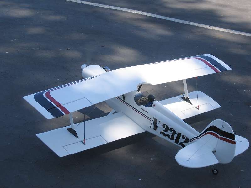

Old 08-08-2004 | 06:42 PM
My Feedback: (15)
Posts: 60
From: Poway, CA
Hey!!
This is a nice flying plane! Saito 120 is very good motor for that. Lots of power, nice handling on the ground.
Here is a couple pictures.

Old 08-09-2004 | 02:33 AM
David74's Avatar
Posts: 109
From: Toronto, ON, CANADA
nice shots PlaneRacer!!! This plane does look really good.. what about dead stick landings, I heard it is kind of a brick.
