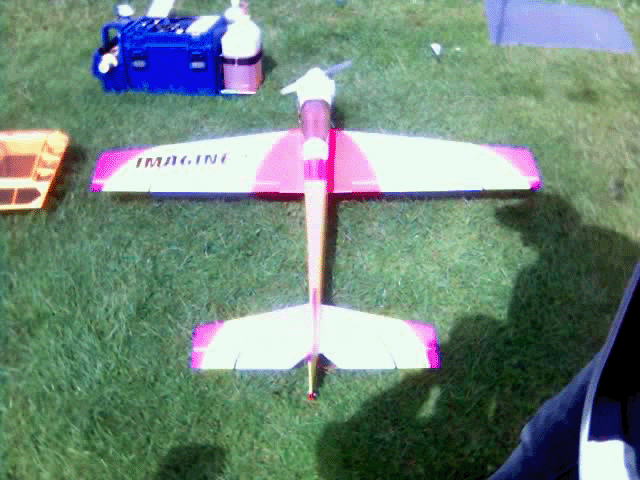

Hi i am new to this well new compared to all you
i have been flying for under a year and learnt on my
irvine tutor 40 with an irvine 46 abc up front
now that i have passed my bronze test and can fly solo
i bought the thunder tiger 50 and put in an irvine 53
which by the way was no mean feet as the 53 comes with a
super quiet silencer that the IMAGINE dose not like so a bit of moding
on my part and a little squeez and hey presto its in just but its in
now the problem i have is that the plane faild its sound test and we have a limit
at our field of 82 Db
mine regesterd 85 Db
now i need to know how to quieten it down a bit
engine is in cowl
muffler is half in half out of cowl
Muffler is touching fuse at the end
props used for test were
10X9 11X7 12X6

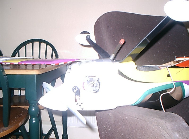

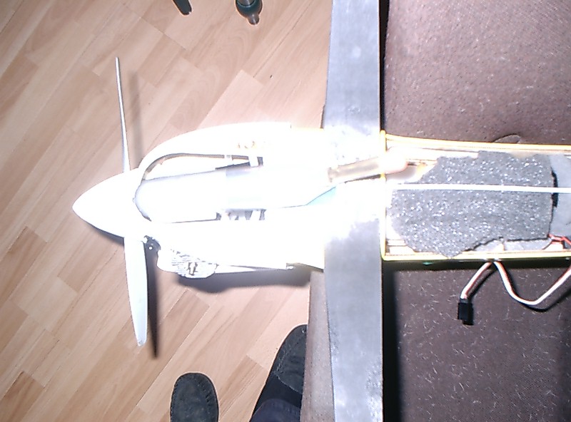

As many have said 82Db is low but we have a professional complainer that
lives near our site and he got the council out to sound test and they came up with
the 82Db
i placed some wing tape around the inside of my cowl as there is a 3mm space
all around and i re cut the holes for the needle valve and such as to increase
the clearance
i have also re-cut a new scoop for the muffler but there is still some contact
and i don't think i can cut anymore out
the muffler sits at a strange angle and there is no way that i can see to
straighten it up
what i would like to do is get an extension for between
the engine and the muffler that would push the muffler out just enough
to clear the fuse but i cant find any where on-line that does them
and my local model shop has no idea what i am talking about
this is a pain as i have only flew it once and loved it
HEEEEEEEEEEEEEEELLLLLLLLLLLLLLLLP................. ...........

Getting the silencer more outward is simple! Just fit a spacer ...let´s say 8mm thick of aluminum between the silencer and the engine.
Make it yourself by sawing, drilling and filing...have done this myself on several engines...works fine. Just get longer Allen bolts for the silencer!
As for props try a 11x8 or a 11x9 APC I would not try a 3-blade prop as most of the time they are inferior to 2-blade props performance-wise and as loud or louder.

OS, Du Bro, and Magnum all make those spacers for around five bucks.
Ernie
