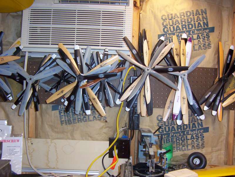

Three blade selection not so limited.

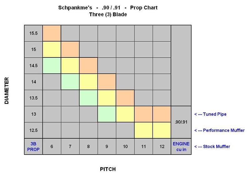

Here's a Three-Blade Prop Chart.
Remember, as you go up in Pitch (6 to 8 to 10) you also increase speed
_________
Schpankme

....OK, Hobbsy....'yer busted. Now we see where all the 3-bladers went.
FBD.

Hobbsy, I hope that it doesn't take all those three blade props for Me to find the optimum one for the magnum .91???!!! [X(]. Top end performance isn't as important to me as loww end as in getting her up in the air faster. The runway is short with trees at each end so up and down quick are important.

I suspect a 12x8 three blade would be about right, Graupner and MA and Zinger all make then. I use three bladers almost exclusively, so I have them from .15 siezed engines to a SuperTigre 4500, I'm converting the 4500 to Diesel operation so I'll need a bigger one yet. In the neighborhood of a 20x10 three blade. Something to keep it in the 7,500 rpm range.
