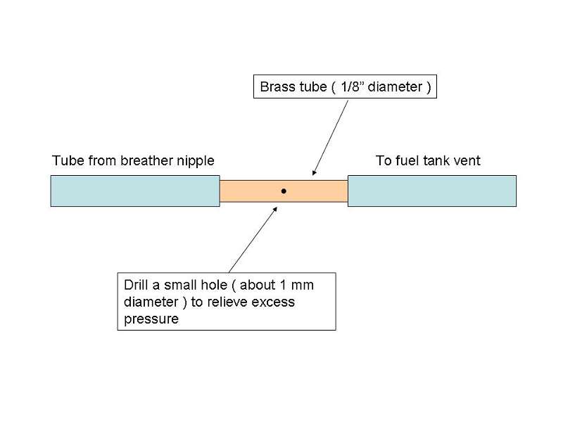

My Saito 100 was working ok but when high Gs involved, the engine was struggling a bit. A pump would solve the problem but instead I tried this :
I connected the breather line directly to the tank vent line. The result generated too much pressure that I can not regulate by leaning the needle. Then I put a small brass tube between the breather and vent connection I made ( see attachment ), and made a tiny hole in this tube in order to relieve excess pressure.
I have to say that it worked like a charm. Now whatever I do, engine works like a clock, and there is no richening in the midrange. The pressure generated by this setup is more than muffler generated pressure. High speed needle needs to be leaned a bit, low speed mixture is not affected by this setup.
I used a 1/8" brass tube with a hole diameter of about 1 milimeter. You can enlarge the hole if there is still excess pressure.
The advantage of this over a pump is it is cheaper, simpler and it is easy to operate.
I think anyone who has fule draw problem in an engine may use it.
I would like o hear about our comments.
Thanks.

finally i been thinkin of doin the same thing but i didnt want to risk any cam or follower lube problems but i went for it. only instead of using your brass tube idea i used a "T" and put in one of my old OS needle valve's i had laying around that way i could adjust the "relief orfice". I ran it tonight and every thing seemed to work great ill try flyin it tomorrow to put it to the real test

Interesting, every time I have restricted the crankcase pressure performance fell off after a short flight time. My restriction was caused by having a hose too long on the breather.
How long is the hose before you get to the metal tubing with the hole in it?

Jakac_26, if there is an unused one around, I think it is a better idea to use a needle valve. I have to tell the engine is working so well that maybe someone from Saito has to have a look at this setup. This setup contributes to fuel savings also I believe.
Bentgear my tubing between the brass tube and the engine breather is about 3 inches, I think if it kinks during flight, it may cause some performance problems and maybe some serious engine failure, maybe it is better to fix it somewhere in the firewall, I will fix mine.
I made about 50 flights with this setup, lots of full power flat spins, lots of negative ( and positive ) G maneouvers, no problems at all, 0 dead sticks. I think I will do about 20 more flights this weekend, I will keep you posted.

You are going to have trouble with your setup in the long run. You will eventually experience power degradation as bentgear did.
You need to instal a "Tee" in the line between your orifice and the engine and this tee branches to the atmosphere.
as jakac did.

I think Saito Fuel Pump, Style # : SAI300TTDP102, works on the same principle. With one difference, it is $50, our solution is $1.
W8ye, I did not understand why I would eventually see power decrease by this setup, can you please tell me why ?

This trick is outlined in the manual for Saito twin engines by way of an picture (I believe the engine in the picture is the Saito 300TTDP, but I may be wrong). The picture shows a pressure adjusting valve to the vent line (as with the needle valve mentioned earlier by Jakac_26). The manual is available at the Horizon Web site.

ORIGINAL: obolel
i think w8ye meant that if its not vented to atmosphere the bottom end of you engine will not get the amount of lubrication it needs . once the pressure equalizes there will be no more movement of oil to the crankcase, which is why the vent is on the crankcase to start with.
