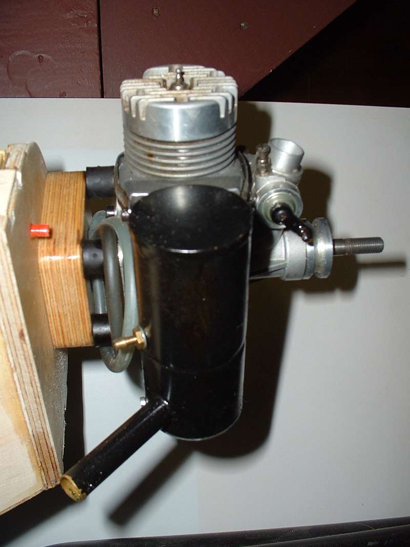

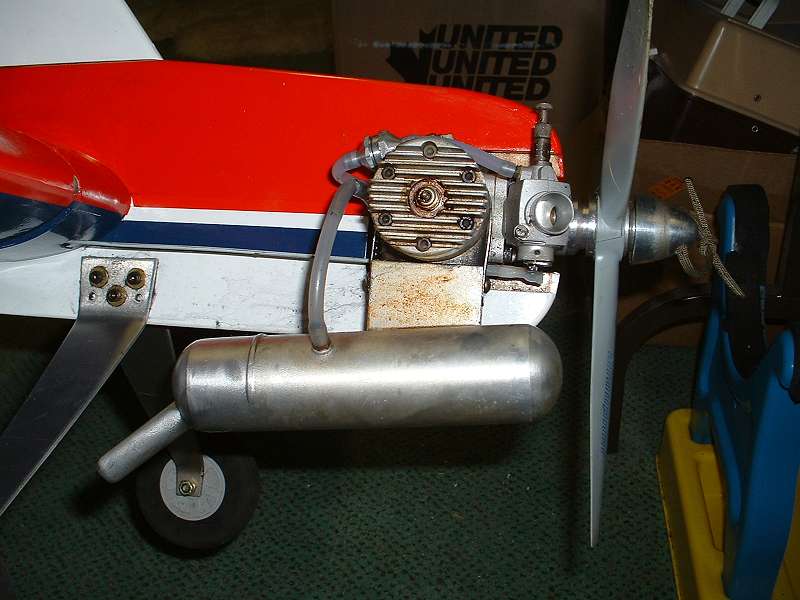

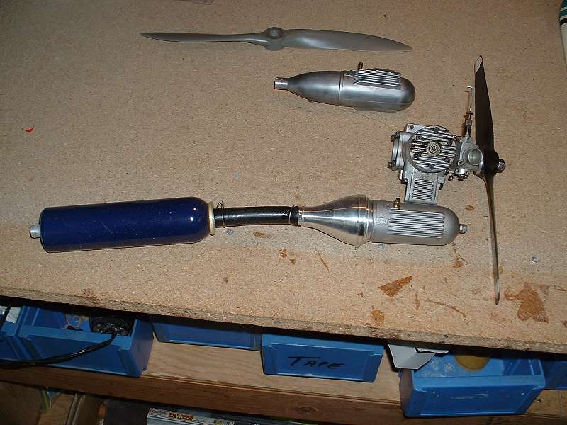

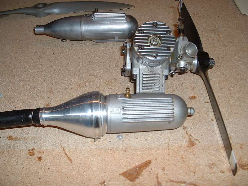

The Bisson (BCM) will be quieter due to the greater volume. Bisson also makes a strap on muffler that isn't bad. Davis Diesel offers very nice strap on German made steel mufflers that are very effective - picture attached. I managed to get one plane down to 88 Db using one of their strap on mufflers (not Pitts style). If you're really serious about noise control you can experiment with mufflers. Here are a few pix of the Dubro Arise muffler used in conjunction with a home made mousse can muffler - not a tuned pipe, it's baffled too. Very effective, and minimal power loss. Volume and baffling are the key to effective muffling. Use of a prop with more load to drop the RPM is necessary as well (less diameter - more pitch). Prop tip noise is the enemy. The slower you can run the prop (keeping the tips from approaching Mach) the better - APC props are quiter than most, those thin tips are very efficient.

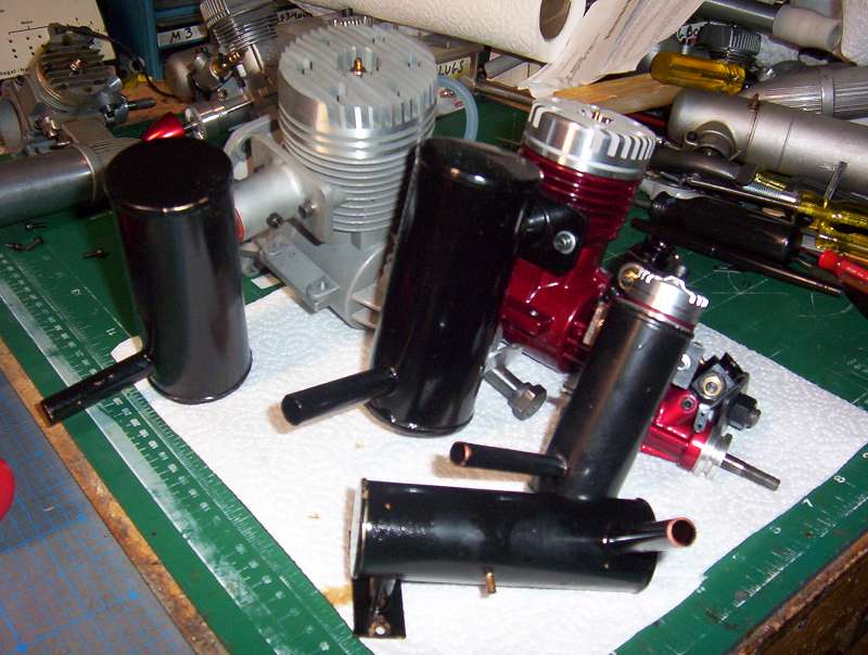

These are the current Davis In Cowl mufflers, they are of high quality, very quiet and do not effect rpm. The engines are an MDS 2.18, Irvine 1.50 and a Dieselized Irvine .25, the extra muffler goes on a Super Tigre .90 also Dieselized. You'll just have to excuse the clutter on my work bench, I'm suffering from a real bad case of projectitis and have been going through engines checking bearings, re-building an engine for a friend, you know how it goes.

Hobbsy - looks like you like doing it quietly too. Nice to see. Those Davis Diesel mufflers aren't cheap, but they sure do the trick. I've even got their biggest can on my G-62. I notice that usually threads on quietening things down die a quick death - no interest I guess... until flying fields are lost. Too bad as only a little effort can bring remarkeable improvement with little power loss. Personally, I find it less stressful and more enjoyable to fly quieter planes. I certainly can see the beauty of electrics, but I like engines! Nothing worse than some guy with a loud engine tuning his screaming beast in the pits.

Daryl, I also have the In Cowl fourstroke SoundMaster for 120 sized fourstrokes and it works great on my old high compression Saito 150, I'm going to try it on my new Enya 1.55, the 1.55 has an irritating bark in the exhaust that I don't like. Could you give us a pic. of the G 62 one. Thanks

Hobbsy - here's a pix of the G-62 setup. This is the largest can they sell. It was about $110 and they want about $75 (ouch!) for the flex pipe. I managed to score the flex pipe for considerably less off the 'net. I'm running an APC 21 X 12 component 3 blade prop with it and most of the glow powered planes drown me out when I'm flying. Still have pretty decent power too, but of course it's restrictive and there has to be some power loss involved. It's the quietest gasser I've ever heard! Getting back to the topic though, N1EDM, if noise is an issue at your field you should take RC34074 up on his offer - that strap on muffler he's offering is exactly the one I used to tone my S.T. 90 down to 88 Db! It's probably the most effective off the shelf option available, and $30.00 is very reasonable - they are not cheap.
