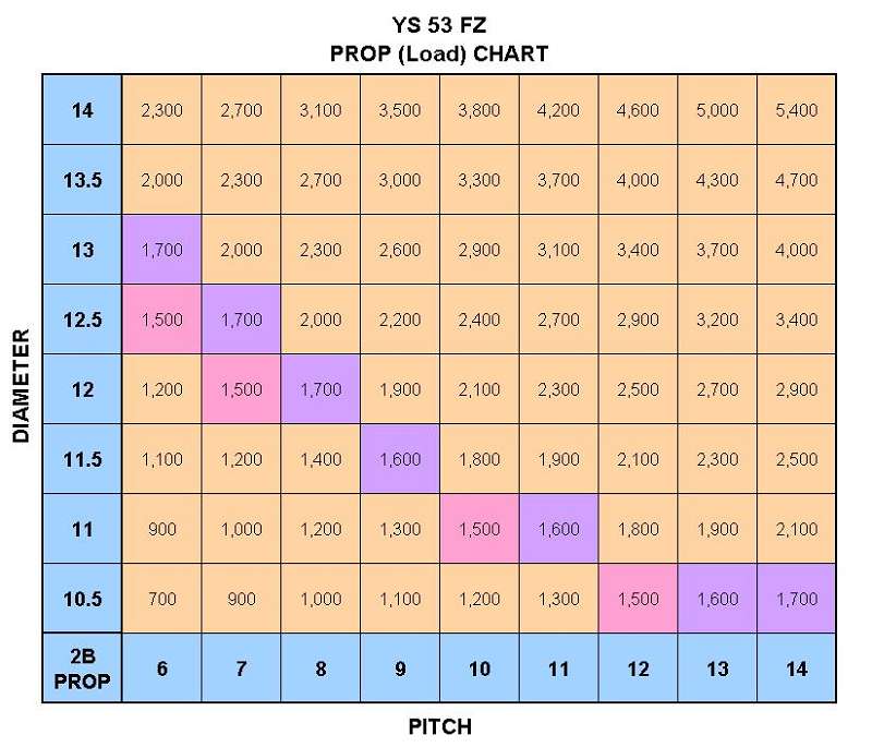

Schpankme,
Do you happen to have a prop chart indexed by prop load?
This T/F prop chart, indexed by prop diameter, keeps being displayed by well meaning members, simply because no one has yet published a better one....
It can only give you a starting point, but nothing even close to a definitive answer, to the actual range of props your engine can use.
This range is affected by the prop's load on the engine, not its diameter.
This since a 10x8 is much heavier than an 11x4. Yet this chart suggests the 11x4 for a .53 and the 10x8 for an engine as small as a .37...
As far as I am concerned, just guessing will give you just as good an answer, as will using this chart.

If you treat the YS .53 as a .70 or .75 as it should be treated, the chart shows a prop in the 13x6 range, I have run a 12x6 three blade on both of my .53s in the 9,900 rpm range, this would approximate a 13x6. This tells me the chart is OK.

Here are some numbers from my YS .53 FZ with no lowspeed needle, I have one with and one without.
Done today, about 55 degrees F
Fuel--WildCat Pro mix 20% nitro with 18% 95%/5% synthetic castor blend lube.
Hangar 9 SuperPlug Han 3011
Zinger 12x6-10----8,670 rpm it sounded terrible with this prop.
DynaThrust 12x6----10,560
Graupner 12X6--11.360-- this one was a surprise.
Master AirScrew 12x6 three blade---10,320 a pick up of about 400 rpm over the last time I tached it with this prop. about three more hours on it now.
All the 13x6s I have, have too large of holes in them and I have no suitable adapters.

Dar,
As requested, here's a Prop (load) Chart for the YS 53 FZ.
The most accurate load is between 1600 and 1700 however, it looks like any prop up to a load of 1700 should preform well.

Schpank, in the math, are you treating the YS .53 like a .70 or so? As you can see above, my .53 turned a 12x6 MA three blade at 10,000 plus, which is about where Dave Shadel says to run them.
Old 12-09-2004 | 10:07 PM
Schpankme's Avatar
Joined: Jun 2004
Posts: 267
Default RE: Propeller selection
hobbsy,
You just showeed that your "YS 53" used a 12x6x3B @ 10,000.
The chart says it should swing a 11.5x6x3B, where are we in conflict ?
Your test proves I'm under proped on my charts ?
