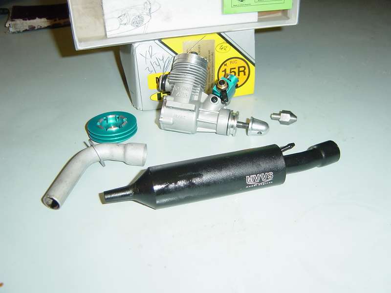

Old 12-24-2004 | 10:07 AM
Posts: 12,957
From: Hesperia Michigan, MI
Default RE: Using car engines in planes?
dieseldan.....can you post a photo of your Irvine .15? Thanks Capt,n

Old 12-25-2004 | 11:47 AM
AMB
Joined: Jun 2003
Posts: 6,748
From: winter park, FL
Ok here it is I got it with an MVVS tuned minipipe and a 70 degree stack you can see that that stock glow head is the irvine car head with most of the fins cut off (it came that way from just engines It has a diesel head made by AJ colholic.it also has the extended collet
nut for the prop but the AP 09 prop nut also fits fine for prop installation it sort of got side tracked for other projects I am
planning to use it in a fred reese ultimate pipe ( when it get built 10=20 size) I am sorry I did not record numbers one the test runs
glow or diesel but both were impressive my thoughts a fox 15 will do just as well ,martin
and MERRY CHRISTMAS TOO ALL
