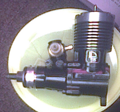

Default RE: 4-STROKE engine is equivelent to what 2-stroke
Dave:
...William Robisons Thermodynamically Enhanced cylinders.
That shore do sound high brow, don't it?
It's is a treatment all my four stroke engines get, and sometimes I'll do a two stroke also.
Really, it's nothing more than black baked enamel on the ouotside.
Bill.

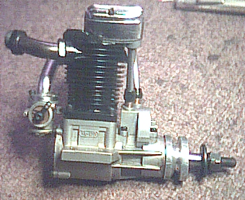

Sorry about that Sky, I was just having a little fun with my good friend William. This is the engine.

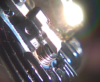

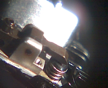

Here are some shots of the "Real" GK, and one of what I sometimes call the "White Knight."
First shot is inside the front of the case, black arrow pointing to the ring that's not machined, showing the black color. Second and third show the GK rocker pedestal and the WK pedestal, the WK is still natural aluminum color.
Bill.
