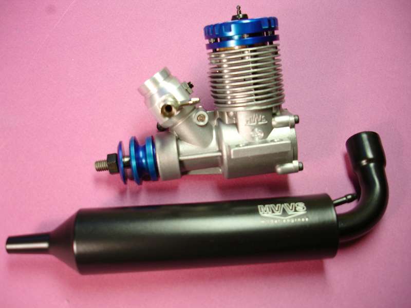

Hello!
How about a MVVS.28 with minipipe?
You find them here..
http://hem.passagen.se/airracing
[email protected]
Regards!
Jan K
