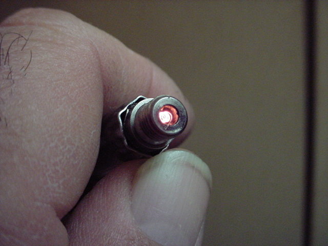

Here's a glow plug and a glow plug igniter....(small battery inside)
....here's what happens when you connect the two.
That red hot glow stays like that, even when you disconnect the igniter, as
long as the engine is running.....it keeps "glowing" like that, and the engine
keeps on running.
FBD.
