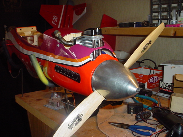

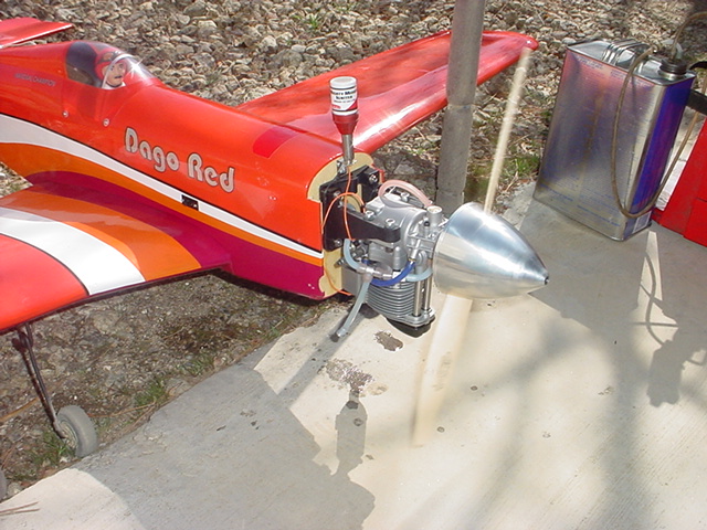

....I set mine up as per instructions, and haven't touched it since. Set both
needles 1 1/2 turns out, regulator set flush. OS type F plug. I use PowerMaster
20/20 fuel with some added castor. Zinger 14-8 prop. I use fuel dots.
It runs better every lap....I love it.
FBD.
