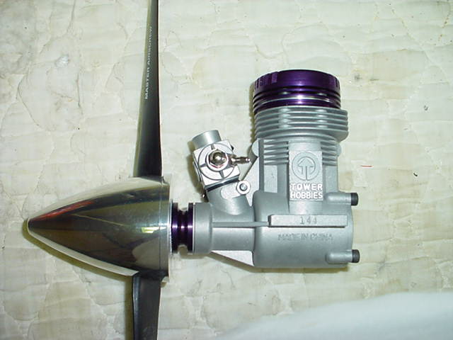

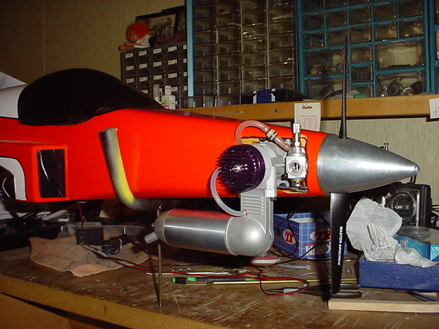

As much as I love the K&B's....the Tower .75 at $95.00 will whoop the
pants off the K&B's. They have massive schnuerle ports, a great twin
needle carb, and comes with a tuned muffler.
If you want vertical....put the Tower .75 in the .46 sized Sukuoi and see
what vertical is all about....it won't even slow down ! [X(]
Dave.

The K&B barely fits in the cowl. Don't know if the tower will.[&:]
