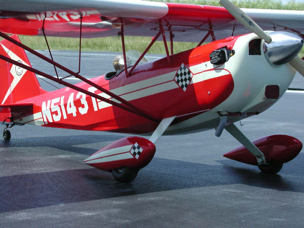

The current setup is a 3 line setup ... vent line, tank to carb line and muffler to tank line ...
fuel system is the same ... only the motor was changed ... enya 120 R to a Enya 1.55 R ... The 1.20 ran fine not pressurized ...
thus acting like a dual vented tank ... I would think ...
only plugged off the pressure fitting to the muffler.
Same for the 1.55 ... only the 1.55 acts like it starves for fuel at the High end ... when I do get it to run at high RPMs (full throttle) .... I have a very narrow adjustment range ... making it hard to tune for peak performance ... motor has 1 flight on it .. which almost was its last ... dead stick landings are not fun when initialized at 150 ft upline to hammerhead and motor dies before you reach the top! nice tailside though ... but not much room for error when ground is coming up quickly and you need to find the runway in a hurry ... I made it with a textbook landing ... but the cardiovascular system got a workout!
other than that, I ran 2 16 oz tankfulls in it prior to flight and I was only semi confident in the setting ... which did seem to be ok for the ground ... not in the air ... Motor seemed to want to run on the lean side of the setting but I choose to stay on the rich side because of the new motor sysdrome ... fuel used: 15% cool power.
motor also had a 16 oz tank ran through it on the bench ... which dad said he had it adjusted and running fine ... I told him that was on the bench and not in-cowl nor in the plane and did not count for more than a good starting point ...

With my tank positioned with the center of the tank about equal or a little less than in line with the spray bar on the carb....... I do not run pressure. I have a lot more movement on the needle valve for fine tuning. The engine runs fine inverted or not. The only time I use pressure is when I am flying my Sig SE and the tank is too low. I run the line that would be used as a pressure line out the bottom of the cowl as an overflow line. Several of us do this. What did people do when they had no muffler? They could not run pressure and the engine ran just fine. JMHO
Posts: 1,125
From: Adelaide, South Australia
On first flights with a new engine (assuming it passes the nose high test) I'll always try to use no muffler pressure. Some engines are better than others at this. But from the symptoms you've got with the 1.55 it sounds like it needs the pressure because the carb can't generate enough fuel draw. Any RC engine will run just fine on the bench with no muffler pressure although transition could be affected if the carb is designed around muffler pressure.
