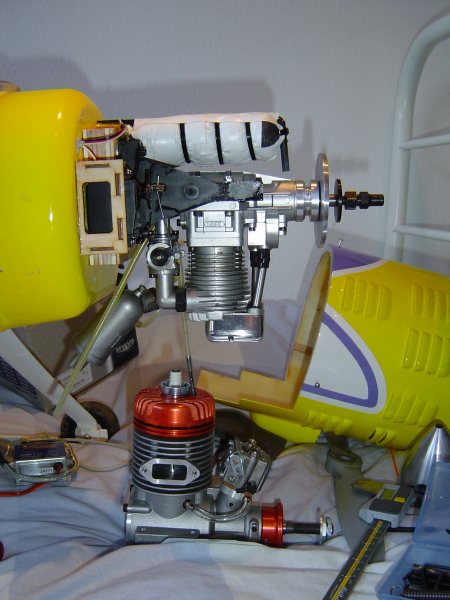

No need for onboard glow on mine.
runs great..,
ID:	233600   Click image for larger version
ID:	233601   Click image for larger version
ID:	233602   Click image for larger version
