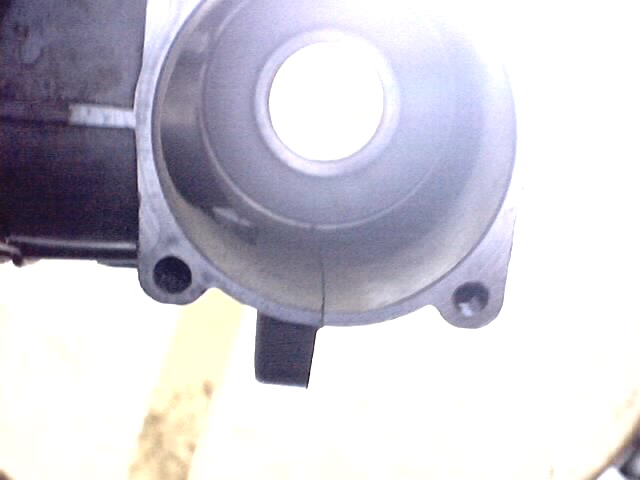

How do you have the needle valve set at on the .40 LA. ? 2 1/2 turns using 15% fuel is flawless. I just discovered my crank case is cracked and every thing you are describing is happening with my egine now.

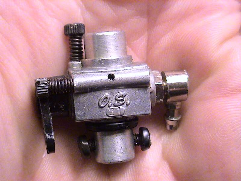

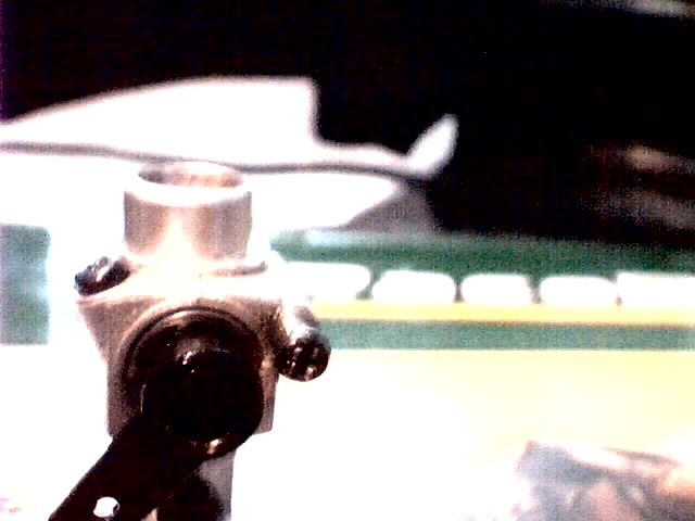

Sounds like you have the wrong needle valve , My OS .40 LA doesn't have a low speed needle valve. But it does have a carb bleed screw. This srcew is located on the carbs body . When I get my camera going again I will post pics. As far as it being a lemon I doubt it but one nver knows.
I found the crack to when I took the back plate off . I had this plate off 2 times prior to today and never noticed it . It is a hair line crack right underneath the flanges for mounting. The one reason I new I was losing compression was because when I first bought this engine used , I was able to crank the shaft with my hand over the muffler's exhaust pipe and fuel would flow into the carb.

Idle needle on this engine is an air-bleed needle, it governs the amount of air coming into the carb at low speed. You can see the hole up front on the carb where the air comes in. factory setting on every OS with air-bleed screw is: hole half closed by screw, adjust it from there, mostly you have to open it some.
