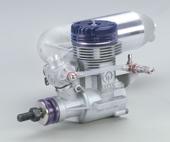

There are plenty of good engines in this range. I would go with the Super Tiger
.75 ringed, or the Tower .75 ABC. Both reliable, powerful engines....easy to
adjust, good warranty, and good parts availability.
FBD.
Old 05-11-2005 | 12:59 AM
Flyboy Dave's Avatar
My Feedback: (21)
Posts: 13,864
Received 10 Likes on 10 Posts
From: Pinon Hills, CA
Default RE: Engine Recommendation for Sig 4Star 60
The Tower is about $95.00. The needle valve can be moved to the front
position if desired. The Super Tiger is $110.00. Either one will do a great
job on your plane.
FBD.

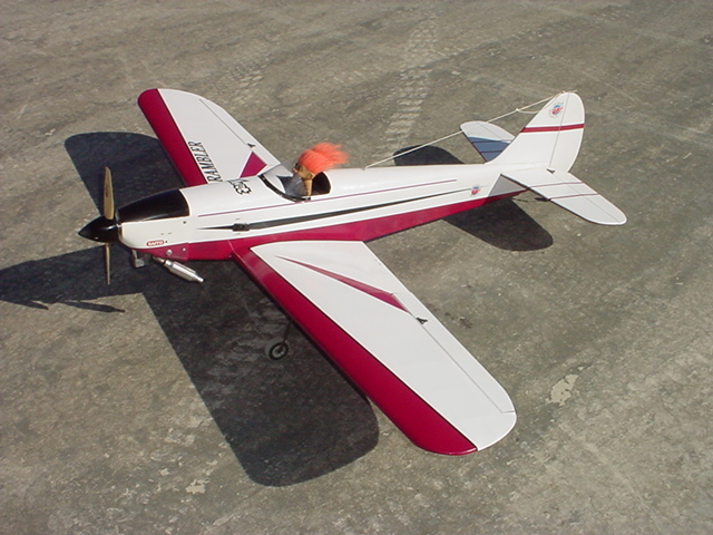

ORIGINAL: old propnut
Go with a 91 4stroke you cant go wrong. take one rib bay off each
wing and add 1 in. to the rudder. Changes the 4 Star 60 into a real
go getter. use a 14X6 prop.
Old propnut has a good idea with the .91 4-stroke. [sm=thumbup.gif]
The Magnum .91FS can usually be had for around $150.00....perfect
fot that size sport plane.
FBD.
