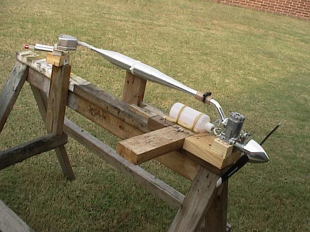

Anyway, here's another example of another off-the-wall setup. Took me probably 20mins with my deWalt circular saw and drill-driver to come up with this contraption.
