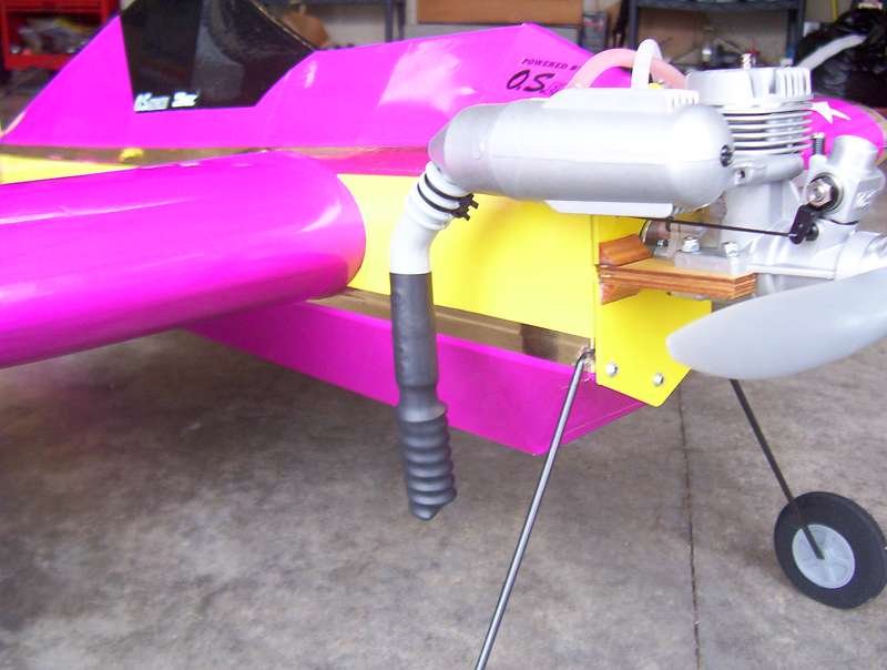

I would have pointed it down --it would have just got out of the prop wash with plenty of clearance from the ground. I think it would do a good job keeping the plane clean.
SPECS: Length: 177mm overall
Length: 165mm from center of mounting holes to end of muffler --6.5 inches
Diameter: 25.3mm at widest point
Diameter: 12mm at narrowest point
Distance between mounting holes: 35mm center to center
Height of exhaust opening: 6.65mm
Width of exhaust opening: 27.1mm
25FX is 30.5mm from mount holes to c/l of shaft or 1.2inches
6.5-1.2=5.3" With a 10" prop this would put you just outside of the theoretical wash.

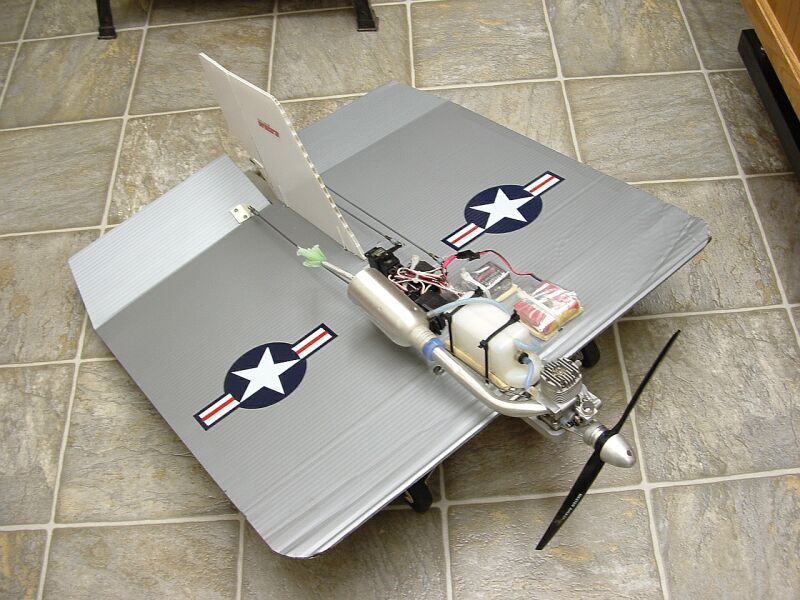

Here is a photo of my PBF. The setup calls for a MAC'S header that goes into the Mouse can held on by friction over the silicone tube. A "Stinger" exits the Mouse can and is held on by JB Weld. Do a search on how to make one. I purchased this one a couple of yeard ago at Hodges Hobbies for 28$ a deal since the header alone goes for 20$. Mac was getting them from a supplier in Florida cant fine the info.
Will post Tach # later in the week.
Pete

Nice photo! The header pipe looks long, like still full length?? The combat guys are running them short, with the header sticking most of the way inside of the mousse can I think. Your setup would probably be "always on the pipe" with good grunt I would think.
What prop for 3D should I run on my Uproar with an OS 32? I am going to try an APC 11x3, would like a light wood prop, but can't find one......
Ernie
