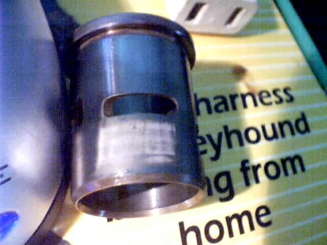

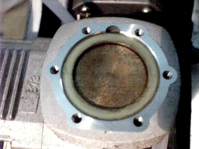

I opened my OS .46 FX and didn't know if I was looking at something good or bad . Feel free to leave your comments and suggestions . Thank you.
The top of the piston looks a little burnt but not real bad. From the pics its hard to tell the condition of the liner.
Whats the compression like? How does it run? These are a better indication of the condition of the motor.

The engine is fairly new about 5 or 6 months old. It runs very good . I can hand start this engine every time on the first flip . The sleeve is smooth , no scratches or blemishes.
The one thing I'm worried about are 1- there is no more tightness when cylinder is DTC. Should I be concerned or should I just continue to fly? Thanks.

I am going to agree with RC-FIEND here. Folks come here to this site to learn about our hobby. People learn how internal combustion engines work by taking them apart! Anyone here with any time under their belt probably gained their experience by experimenting and doing just that.
RC-FIEND, You have done no harm by opening the engine to inspect it. In the future (and you may have already done this) prior to removing the sleeve from the crankcase scribe a small mark so that the cylinder can be replaced back in the same exact position. Also make note of how the piston and rod are removed and make sure you replace it the same exact way they came out.
To answer your original question, the dark discoloration is normal on the top of the piston, thats where detonation takes place. If a significant amount of carbon builds up here, it should be cleaned off, but based on what I can see with the photo yours is fine.
If you want to get some real good reference books on current Glo Engines try and get hold of one of Harry Higleys engine guides or the one from Peter Chin through Model Airplane News. Both have a wealth of information that I still refer to once and a while. Both books will take you through a complete break down and rebuild or reassembly.
If you need any other help, feel free to PM me, or Hobbsy when he is here. He is a very nice gentleman who has considerable experience with model engines.

ORIGINAL: RC-FIEND
It's hard to tell from the glare in the picture #2, but it looks kinda like the
liner is starting to peel. [X(]

What does !QUOT!no low speed needle!QUOT! mean? Since a follow-up post says it is back together, and running fine,
I just read there is a low speed needle which brings me back to the question I deleted . Should I leave it set the way it is or should I play with it to obtain better idling. I guess I won't know until I buy a tachometer.
My Feedback: (13)
Joined: Aug 2002
Posts: 1,109
From: Waldorf,
MD
In all seriousness, it will take a lot (5 or 6 gallons of fuel) before a significant amount of carbon will build up on top of the piston to the point where it will become an issue. If you want to periodically pull off the head to inspect inside, thats O.K. There really is no need to pull the cylinder out, just cycle the piston down and you can inspect the cylinder lining leaving everything intact.
Run good quality fuel with decent lubricant. Use after run for a little extra protection against corrosion, keep the engine and carb clean and your engines will last quite a long time.
The advice woody28 gave you, is for the most part correct, but it does not apply to your engine as it is an ABC engine and has no ring.
As far as your idle goes, its kinda hard to help you with that in this format. I can't hear or see the engine running.
If it will hold a reliable idle and transition smoothly to wide open throttle , I think you are OK.
Consider the books I recommended, I think you would really like them. A lot of the questions you are asking are covered in specific detail along with photos and illustrations.
If it will hold a reliable idle and transition smoothly to wide open throttle , I think you are OK. Consider the books I recommended, I think you would really like them. A lot of the questions you are asking are covered in specific detail along with photos and illustrations.
