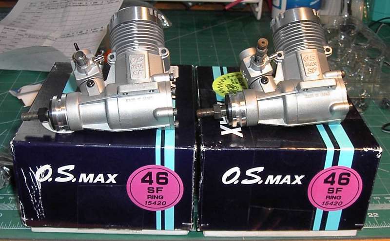

Congratulations, you have TWINS! Can anyone suggest a worthy project? I know that Ed Moorman recently built a Twin Air. Regards to all!

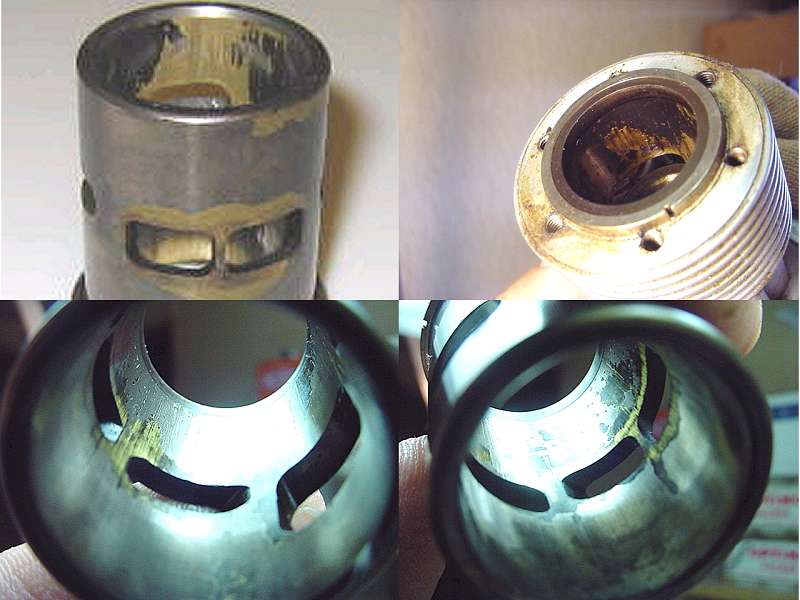

Thanks guys....Took the head off and looked at the liner, underside of lip looked like brass. I didnt think to try a magnet at that time. About 1/8 inch down there is a line (dark) on the piston. I think it is ABN, has the same box as above. The Yeager post. Dave

Dave:
I hope you saw the brass without taking the head off. If you see brass inside the cylinder bore your engine WAS an ABN. It has been converted to junk, the liner has peeled.
For the price of the OS piston and liner set you can buy a much better engine.
Bill.

William....Not inside, under the lip which sits on top of the crankcase, on the outside, there is no brass showing on the inside. It has very little run time on it, maybe 1 tank. Thanks Dave
