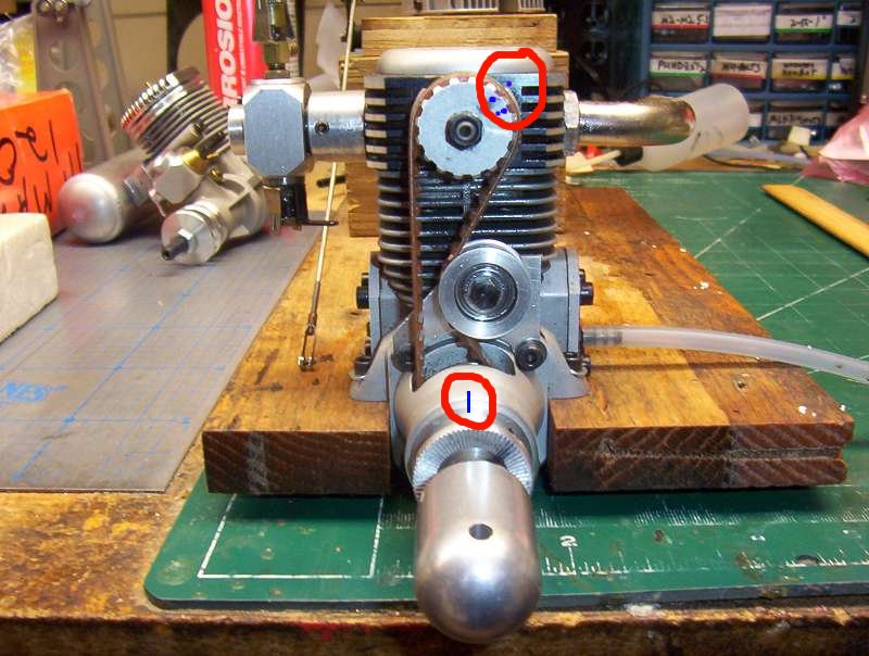

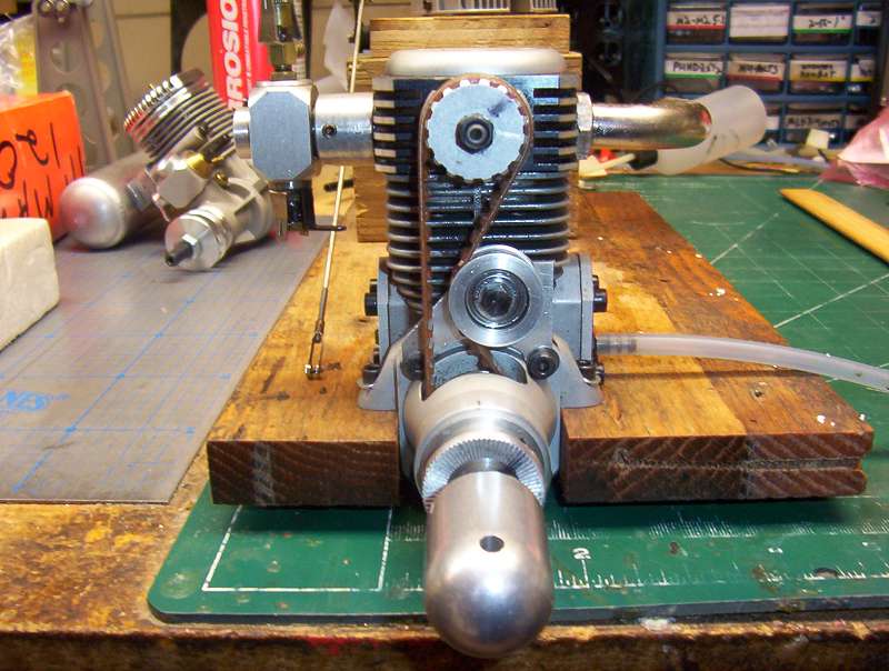

See at the marks of timing of Webra T-4 MK.II at pic. same as my engine has the marks alignet with other marks at the engine. I am using 1 dot, not 2 dots at gearwheel to cylinderhead.
