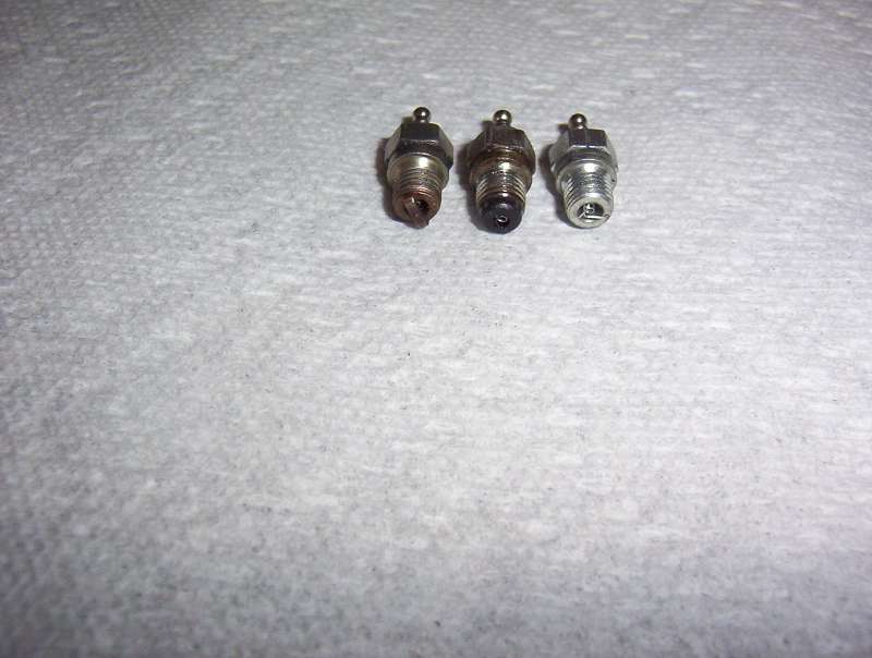

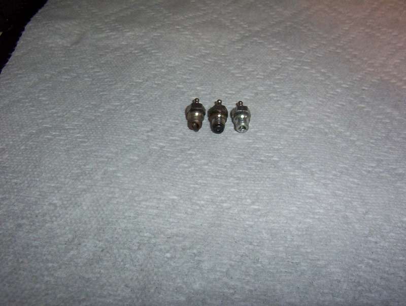

Fox idlebar plug on the left
Fox Miracle plug, good for fourstrokes and most large twostrokes.
Fox standard plug good for most two strokes.
