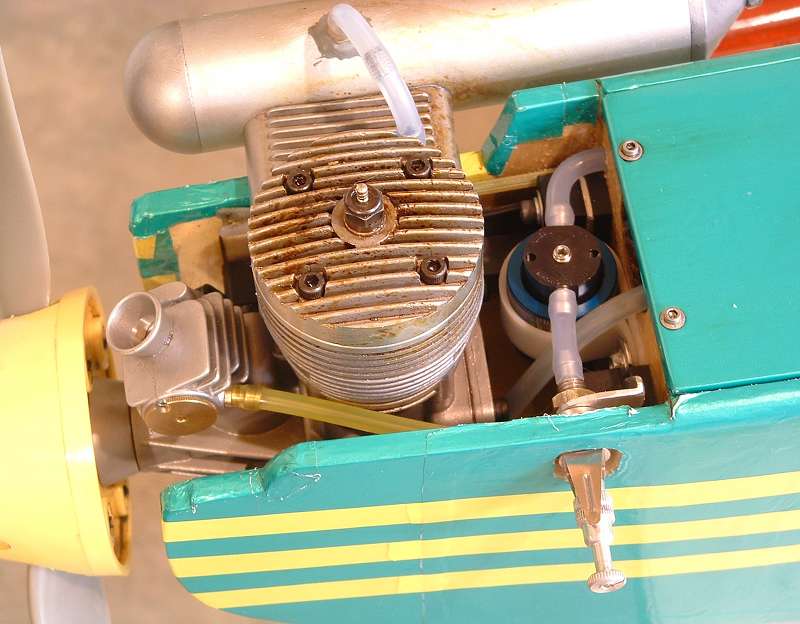

I have a new K&B Sportster .65 engine. It is a light and reasonably powerful engine (APC 13x7 @ 10,200RPM). I am having problems with the mixture going lean gradually between 1/2 and 2/3 of the tank? I use a Dubro 8oz tank with all new hoses and pipes and as high in it's compartment as possible. Tank is surrounded by foam. The remote needle is rigidly mounted at the same height as the spray bar. There are NO bubbles in the fuel line while running (full or not). I have enlarged the hole in the exhaust pressure tap. I have enlarged the id of the pressure line. The spray bar is 3/8 of an inch below the top of the tank (I had to lower the engine).
If I start the flight sloppy rich then I get rather weak performance for about four minutes. Perfect running for four minutes and after that it gets leaner and leaner till it quits. This is a gradual change NOT sudden! My Goldberg Tiger 60 is easy enough to dead-stick but I love the power when set 300 RPM below peak.
Do I need a Cline regulator? Do I need a Perry pump?

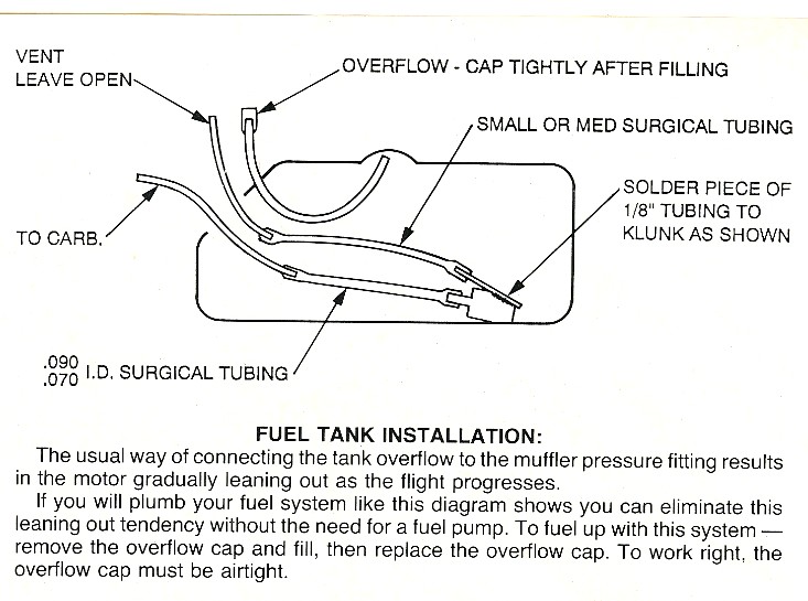

Anybody try the fuel system in the attached drawing? Does it work?

By the way, that diagram you show has no pressure from the engine or exhaust. That means the engine must run completely on suction. I have my doubts about that diagram. I would only add one change to it: connect that vent line to the exhaust pressure tap. Then it becomes a Uni-flow setup which is supposed to work pretty good (control line).

you don't need a pump..... it's the mindless location of the pressure tap which is your problem.... why-o-why did they do that [&:] !!!.... if you were to measure your tank pressure you would find it varies greatly with speed and actuall can go slightly negative!..... plug it with a cut-off screw and put a tap into the muffler, where it belongs.... I bet you can find that the engine even runs better with NO muffler pressure [X(]....

Tonight I tried that screwy three line system and It does not work worth *^%@#&&.

Old 07-15-2005 | 07:34 PM
Posts: 697
From: Middletown, MD
Default RE: Do I need a pump
Perry Pump Installed !
The pump is finally installed and while it was a pain in the a#s it looks fairly neat.
I plan to try it out this sunday.
Francis

I have not seen a pump mounted this way. (vertically) Let us know how it works as the instructions say "for best results" mount horizontally.

I called Perry and they said that a vertical mounting is fine. There is no where else to mount.

You sure don't need a pump! A pump is only needed when you have the tank positioned on the C of G.
Pictures show that you have the tank too low!!!
And for best results you better use either a Tettra "bubbleless tank from Dave Shadel, US Y&S importer or...the tank you have... set up in a "Uniflow" way with two clunks.
The picture you have shown is correct but the vent line must be attached to the pressure nipple once you are about to fly.
You would be much better off if you mounted your engine side-ways instead of right up the way you have now, that way the center of the tank could be positioned correctly at the center of the carb intake.when the airplane sits horizontal...which is very important.

In your third picture , I don't see whats giving the tank pressure. Can you explain a little ?

I don't know if you will need the pump, but your plumming has got me baffled!!!. In picture 1 post #1 your muffler pressure line is connected to a low pressure area of the muffler. I would expect to see a smoke line here not a pressure line. In your second set of pictures you have the low pressure nipple connected to a high pressure nipple (the new one you have tapped), why?
If you connect your pressure line from the 'new nipple' to your tank - top line shown in post #1 picture 3.
Use line 2 (centre line) to fill the tank - then cap.
Use line 3 (bottom line) for fuel to carb.

Your drawing showing the tank set up is OK..It's what the Cl-guys call a "Uniflow" tank set-up and that's the best tank set-up you can have if you use an ordinary R/C fueltank. As I said earlier the Tettra "bubbleless" tank is even superior to the Uniflow tank though.

The venturi in my engine is .342" ( small ??? 8.68mm ). My tank is as high as is possible. My engine has been lowered. The spraybar is 3/8" below the top of the tank. The tank is as close as possible to the firewall. I tried that screwy three line, special; clunk system and It does not work worth *^%@#&&. The pressure tap on the the exhaust stubb area on the silencer is where K&B put it. I moved it to the muffler body with no luck.

The plumming that has got you baffled is aeasy way to block off the now unused pressure taps.
