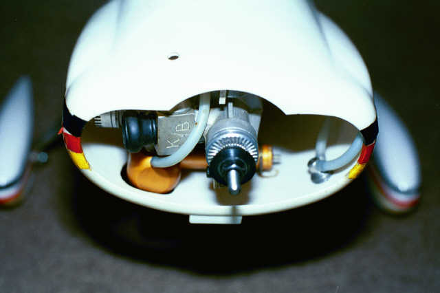

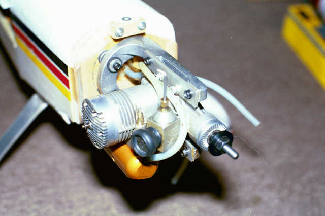

Default RE: .61 strong thrust or not..

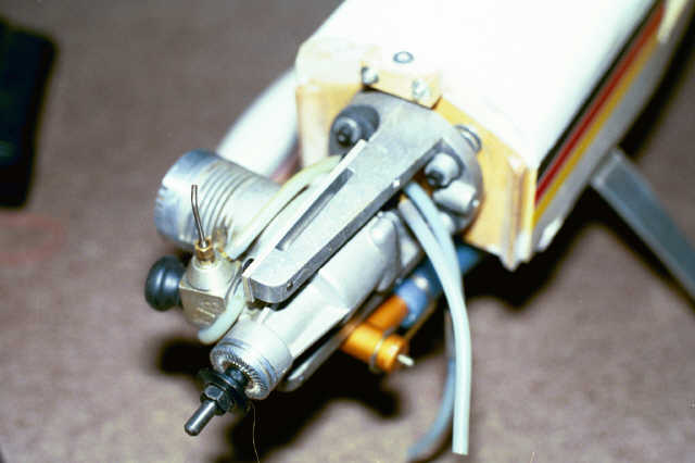

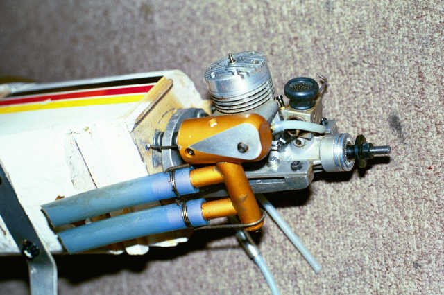

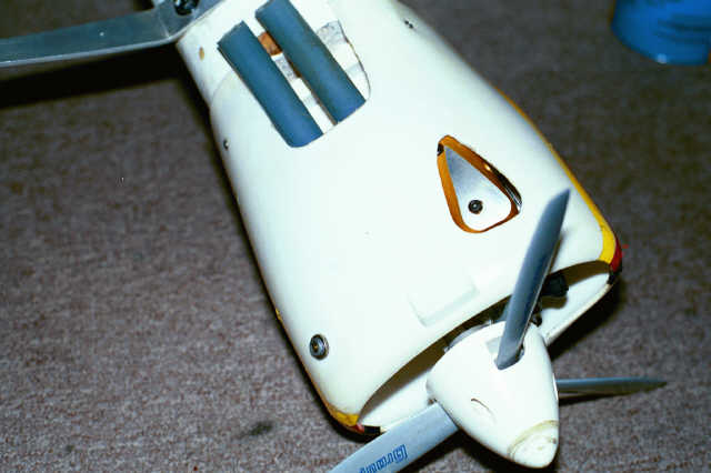

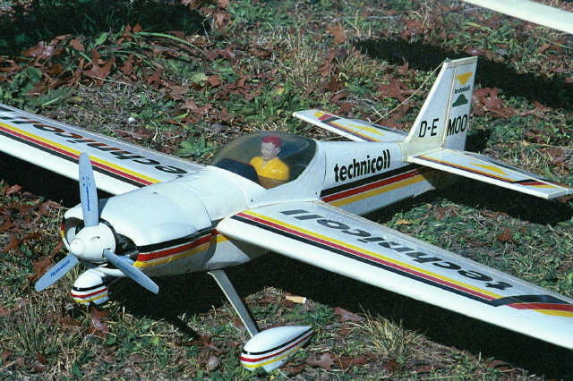

The K&B 61 is the exception to the heavy rule. As noted in an earlier post, its weight is on a par with most 40-46 engines, and it's considerably more powerful.
An excellent engine choice for any 40-46 plane you want to make faster/sportier.
One example is my Diablo 40. With the K&B ringed 61 installed it will take off vertically from my hand.
And it's almost impossible to hurt it.
Bill.
PS: As you can see, it makes a neat installation. wr.

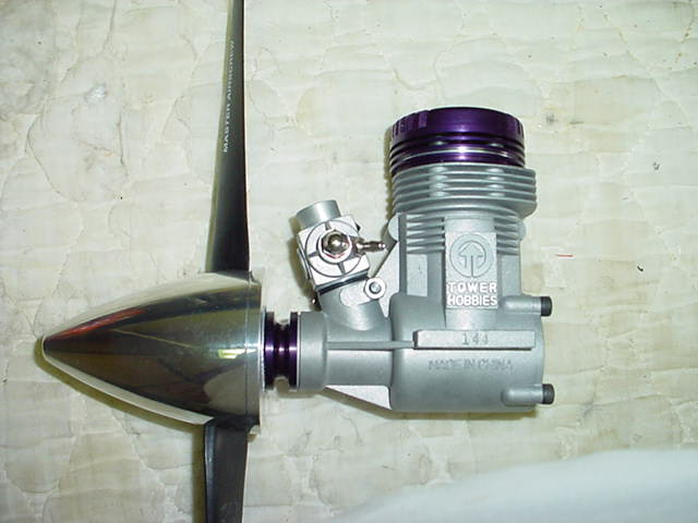

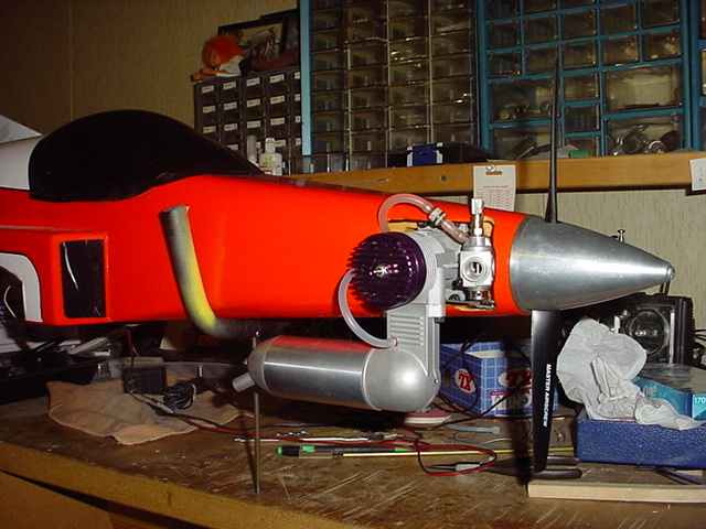

The Tower .75 rules the roost right now in the "below 90 size". It will whoop
up on most of the 90's....but on the other hand, it's not too good for torque
or 3D....it's a screamer.
FBD.
