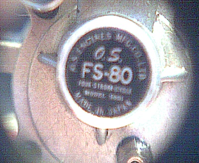

Hi, I am in the process of dismantling an early OSFS 60 ( open rocker type) as it needs new bearings and have ground to a halt. I can't see how to get at the bearing under the rear gear where the valve lifters live. It looks like I will have to remove the OS60 badge but it's not obvious to me how to do this. I notice that there are two small cutouts on the badge. Do I put a small scredriver in one of these and twist it off? I don't want to ruin anything so thought I would ask first. I would appreciate any advice here.

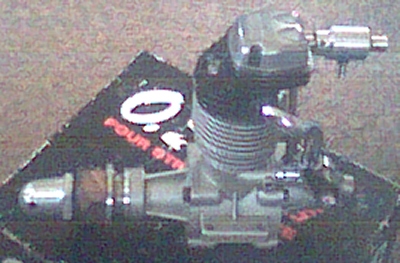

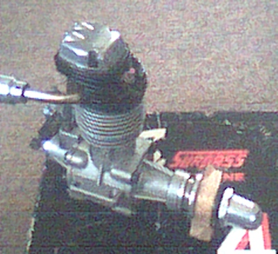

Boz:
Pictures are a little newer engine with a complete rocker box, but still close.
The rear cover just pries off - an o-ring snaps in a groove to hold it.
When the cover is off you will see a slotted head screw that holds the camshaft in the bearing. Be advised, this screw is a LEFT hand thread. If you break it you'll probably never get a replacement, be careful.
