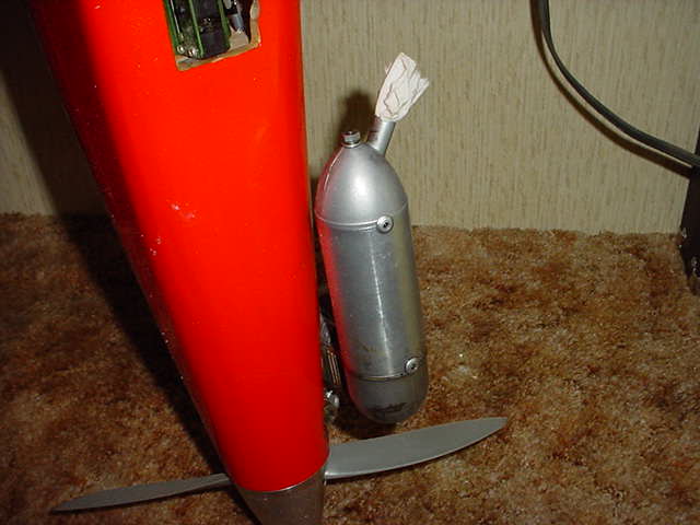

Default Yo, Wayne....
....take the muffler apart, and lock-tite the threads
on the through bolt before you run it. They tend to
loosen, and the rear outlet will start to rotate. I
finally put two small pop-rivets in the underside
of the pipe to cure the turning problem for good.
