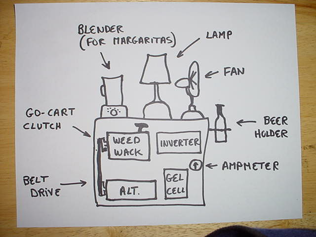

How about a weed whacker ?
1- has it's own cooling
2- plenty of torque
3- has it's own fuel tank
4- easy to put a pulley on the output shaft
5- has it's own pull starter
6- cheap, about 100 bucks
7- reliable, low PRM
Just strip it down, and figure a way to mount it.

Originally posted by Flyboy Dave
I know ChuckAuger will like it....
Did you ever get the aluminum baseball bat??
My Feedback: (21)
....you think I forgot ? ( heh heh heh ). The tiny
fridge plugs into the inverter. The lamp is just
to have some light when your'e grabbin' a cold
one at night. :stupid:
Add an electric razor, and the plane chargin'
stuff....you can fly all summer, even at night,
and never have to leave the field. In Ireland...
you have to make hay while the sun is shinin'.
( Yes I got the bat today, thanks bro. )
