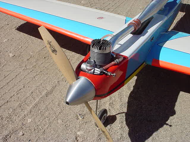

There's no .60 on this planet that will rev with
an 11/11 prop. As an example....a Jett .90....
( a bad-ass motor) calls for an 11-8 prop. The
best you could do would probably be an 11-7 1/2
MAS. If the TT .61 is a "torquer"....( under 12 K
RPM's ) a 12-8 Zinger might work.
I don't mean to sound like a "smarty", or spoil
your plans....just tryin' to help. This O.S. .61 RF
is out-pullin' my old FSR on the Super Kaos, and
will not slow down goin' verticle. The MAS props
will out pull the APC's due to wider tips IMHO.
The RF is only turning 11,400 on the ground
( with the pipe ) and pulls like crazy with the 12-8
Zinger.
Just tryin' to help, like I said....try the 11-71/2
MAS, and if anything works better....lemme know.
Good luck...Dave.

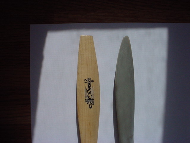

....What' the diff. between the "Hanno" RF, and the
regular RF in my post #6 ?
I might have kept my hat out of the ring on this
one
....APC's are a horse of a different
color, for sure. Their thrust seems to come more
from the hub...to about 2/3 out towards the tips.
From that point on....the tips taper almost to a
point, as well as the pitch diminishing to almost
nothing at the tips.
When I talk about props, I generalize....and refer
to "regular" props. The engines see the the APC"s
as smaller props, and will allow more RPM, or allow
more pitch, that wouldn't work with a "regular" prop.
Example : see props below, both 12/8's....say you
were running an O.S., or a T.T. motor with the APC,
( .61's ) and life is good....it's pulling about 12,000
just like is should....plane flies just fine.
Now put the the 12-8 wood prop on.
PRESTO !!! You just turned it into a 10,000 RPM
DOG....
Dave.
