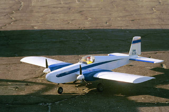

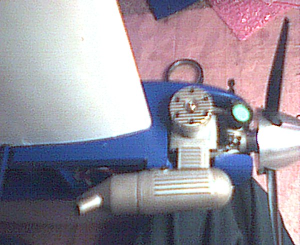

Here's one of my twins, with Magnum XL 46 engines, about ten years old. Second picture is a CU showing the Bru-Line air filter on one engine. Both engines still feel new.
Bill.

Nice twin.
Let me guess, it has a foam wing - right?
Why do I think this to be true? Because the engines are mounted close to the
wing's leading edge, forcing the fuel tank back into the nacelle and causing a
huge slot in the wing's structure. This would be difficult to do and retain enough
strength with a built-up wood wing.

This bet you lose. Built-up wing, the plane is in fact a bashed Hobbico "HobbiStar 60." Still has the original trim on the stab and fin.
Modified to a two piece shoulder wing with an aluminum tube joiner.
Fuel tanks and spars? Simple. No tanks in the nacelles. Each engine has a Perry VP-30 pump, there is a single tank in the main fuselage.
