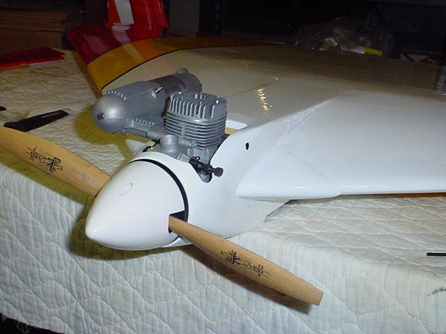

I am running a new ASP .91 two stroke as well. It calls for a 12-6 prop. Yes,
it sounds small....that is a .60 size prop. Even this 13-7 was too much prop
for it....it detonates real bad. The reason is the engine has too much compression.
It blows plugs too. I had to drop to 5% nitro, and a cold plug to run it without it
banging away.
It blew a new Fox Miracle plug on the first run, and a new Rossi cold plug on
the second run on 15%. I am running a 12-7 on it now, and it is OK on 5% nitro.
Any load at all on the engine will cause it to detonate because it is over compressed.
That's the reason for the small props. It's really just a bored out .60 engine. It is
a short stroke engine.
FBD.

Hi!
Why don't you just run 80/20 fuel and mount a decent prop on it...12x7 is way to small for most aplications.

Which ASP 91 are we talking about? The round head or the square head (S) version?

Dave's words don't make this ASP sound very good.
An engine this size, which is supposed to be an OS clone, should not exhibit any over-compression issues, if the 'original' OS .91 wasn't.
As Jim wrote, anything smaller than a 14x6 (13x8, 15x4, 12x10...) is too small.
Most people flying Tai-Ji and similar planes here, with MVVS (and some other) .91 engines, with tuned pipes, use a 14x8 APC and get in the vicinity of 10,000 RPM. Overheating and detonation are not an issue, even for those using 10% nitro.

And Dave is right: the engine is over compressed, or perhaps the squish clearance is too large.
I have been running 80/20 castor fuel through it, it does not work on 15% nitro. After break in (if I can ever get it broken in) 2 or 3% of nitro is probably all that's needed to clean up the transition.
