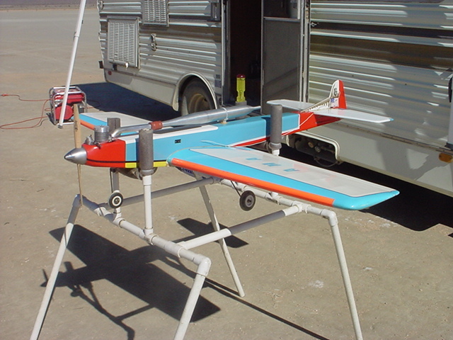

I'd go ahead and join the header and muffler the way they are....too long.
The reason ? It's a low RPM, long stroke motor, and doesn't have to be
wound up real tight on the RPM's for break-in.
After you get a few tanks run through it, check the RPM and see if anything
needs to be done. See the head-pipe on this OS RF long stroke engine ?
I never cut the header because the engine was turning exactly what it was
supposed to turn....11,400, with a 12-8 Zinger, on 15% nitro.
See what the engine is doing before you break out the tubing cutter.
FBD.

My best guess is it would run right along side the OS pattern motor....
....mid elevens with a 12-8 Zinger. The Zinger turned out to be "Best Prop"
for my engine. Did you notice the plane is a an old Kaos ?
FBD.

How could I not? I especially like the the scorched fin! I'll be looking for the numbers soon. My first Moki. They way it's built looks like it could be a stump-puller. Thanks again...Mark
