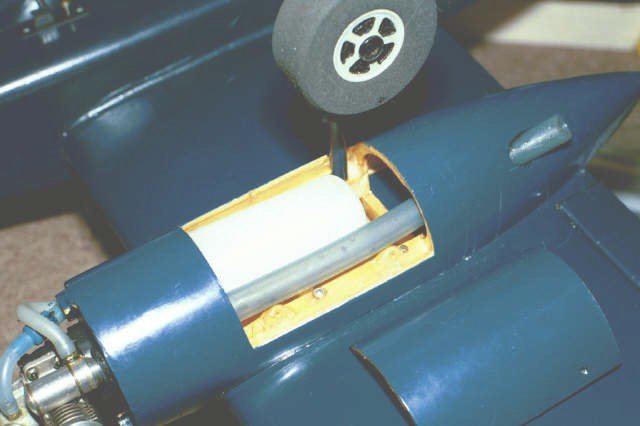

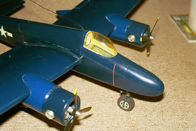

Here's a plane with pair of the AMD 0.061 engines, and a CU of the left engine with the cowling off.
Bill.

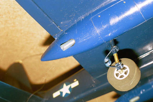

Rude One:
What do you mean, show it off? I didn't post a picture of the nacelle with its working cowl flaps, a picture of the front strut or the main, (all struts are sprung, by the way) nor did I post a picture of the inside of the nacelle showing the tank and the exhaust pipe running out the back. Don't you think I would have had I been wanting to show it off?
Yes, my tongue is in my cheek. Thanks for the compliment.
I like the little airplane very much, it and its AMD engines have given good service for about 15 years now, I'm getting afraid to take it to the field, percentages say I'm going to crash it, I will not be happy if I do.
Bill.
