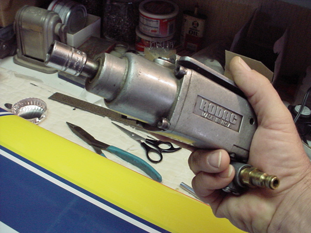

So I bit the prop into the cement driveway today, and when I was trying to take the prop nut off (I have one of those Aluminum Vortex spinners)....it wouldn't come off...to take it off I would grab a prop blade...and then try to wrench off the prop nut, but I end up just turning over the engine....like it's not unscrewing off....I could probably describe the problem better if needed...any help on how to get it off again would be great...

Old 12-28-2005 | 11:13 PM
Flyboy Dave's Avatar
My Feedback: (21)
Posts: 13,864
Received 10 Likes on 10 Posts
From: Pinon Hills, CA
Default RE: Prop Nut Problem....
An air wrench like this will spin the nut off in an instant.
