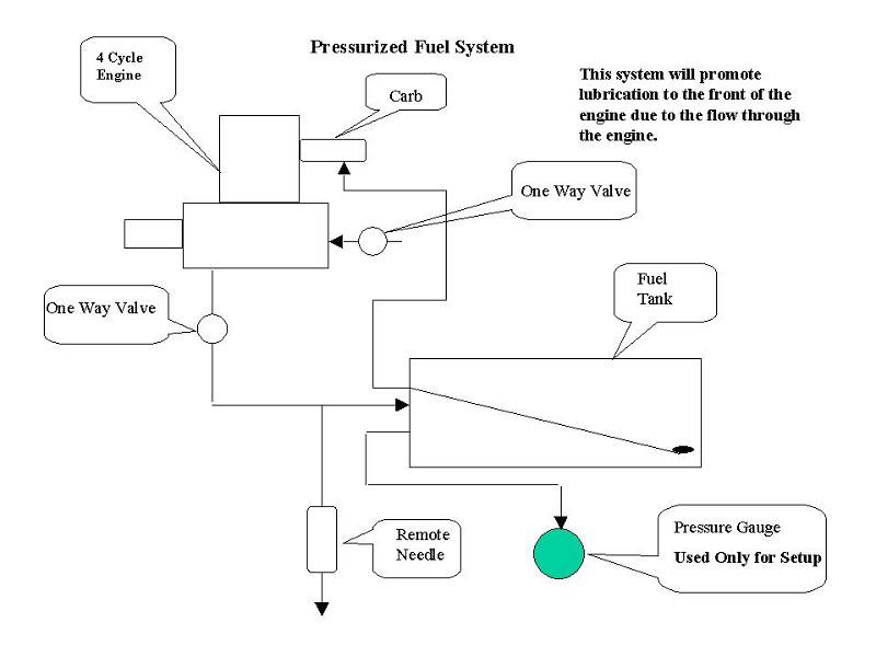

I have a Saito 120 that has a !QUOT!Pump System!QUOT! as stated by Saito. It consists of 2 ports in the crankcase with one way check valves. One allow air in the other out. You hook a hose to the tap that blows out. This hose goes to what I would call a remote needle valve. From there the hose goes to the tank. You use the needle valve to adjust the pressure on the tank. I have a situation with an FS OS engine that I need a pump. I was thinking of adding another port and using the one way check valves made by one of the suppliers. I would put one in to allow air in and one to allow air out. I would get a remote needle valve to adjust the pressure. Does anyone have any experience with this setup?

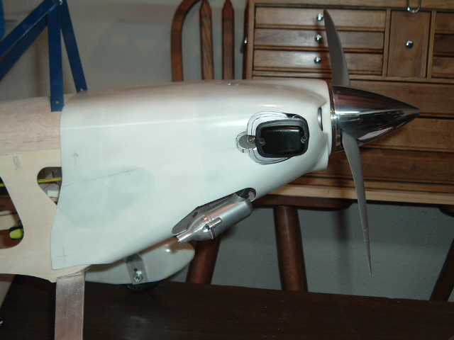

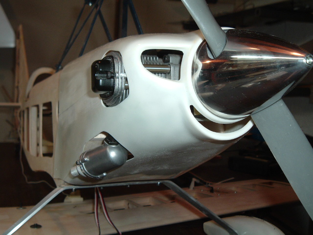

I don't plan on running any muffler pressure. Do these perry pumps accomadate this and if so how do they prime the engine for starting?

The crankcase on a four stroke engine has to breath, You cannot connect a VP30 directly to the crankcase vent. You have to put a tee in the vent line with a restrictor in it.

ORIGINAL: w8ye
Enjoy,
Jim
Paul McIntyre (I hope I remember his last name correctly!), from rec.models.rc.air, posted his experiences with using a Perry/Varsane/Conley VP-30 with an OS FS-91 Surpass. He puts a tee in the crankcase vent tubing and powers the VP-30 from that. He used his while racing in California and says that the impulse from the Tee is more than adequate to drive the VP-30. He also says that the oil drains out of the other side of the tee as is needed for this engine.
Paul is a very experienced modeler and has even designed glow engines with his own brand name on them - Raptor.
Yes, I know it seems unlikely to work, but work it does, according to Paul. I believe Paul without reservation on this matter. Anyone wanting more information on this topic should look up Paul's posts on rec.models.rc.air. They are a couple of years old by now, but are still very relevant.

If I could get an orifice with the correct diameter hole I could do away with the Remote needle valve and simplify this setup.

I did a diagram in case anyone is interested.
