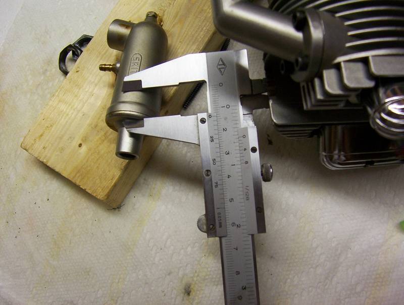

Here are the 2.20 measurements again,

Your caliper on the thread does indeed show 15 mm. The picture I rmember looked like the measurement was taken on an unthreaded area of the pipe.
Your first picture shows 13.76 mm. What is that a measurement of?
On the FA-125, there's only 0.02 mm difference in the pitch between the 1/2-20 and the 13x1.25 threads, a 1/2-20 will screw into the 13 mm thread, but it will be sloppy as the 13 mm is slightly larger in diameter.

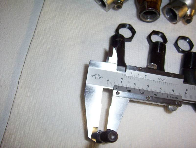

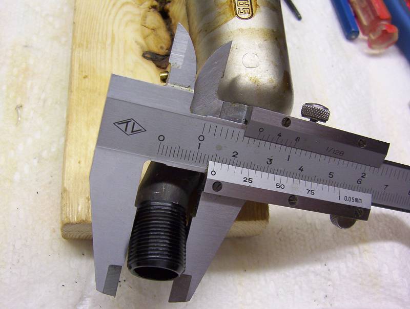

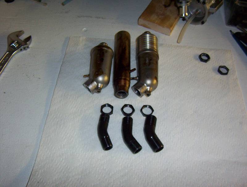

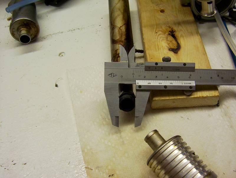

Bill, the first picture (in the above post) is the ID of the 2.20 exhaust port. Interestingly the Saito 1.50 exhaust pipe will slide right into the 2.20 port but is larger than the 1.25 port. The first picture is the measurement of my 1.50 exhaust threads, the middle picture is the 1.25, 1.50 and 2.20 exhaust pipes with their respective nuts, last, I measured a 1/4 inch bolt to make sure my caliper is right on. When did they change the 1.50 to 16mm, Thanks

The FA-150 is 16 mm on the intake port only, the exhaust is still 14 mm.
If you have a 1/2-20 die, see if it will thread easily on the FA-125 pipe. If the pipe is 13 mm the 1/2 die should be 0.012" smaller than the pipe. and as I said, just 0.02 mm difference in pitch.
