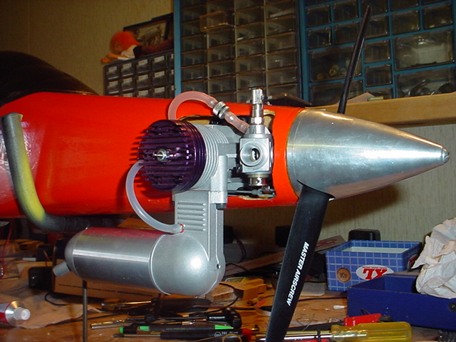

Mount it on it's side. Don't mount the engine inverted.

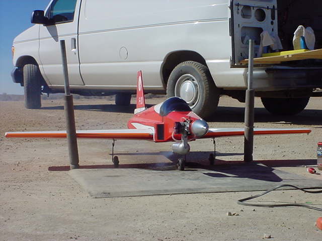

....what Jim said.

Straight and level, about 115-120....tops. The F-20's are kinda fat.

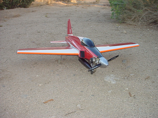

It's El Mirage Dry Lake in So. Cal....about a mile wide and 6-7 miles long. That's
my other F-20, a 45 Rossi powered 40 size Cermark plane. I was racing against
Razor with his Jett 50 powered Patriot....it was a tie !
The surface is flat as a pancake, you can take off or land in any direction.
