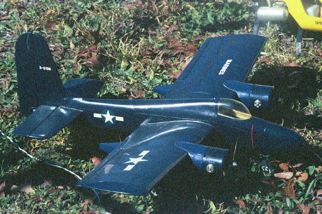

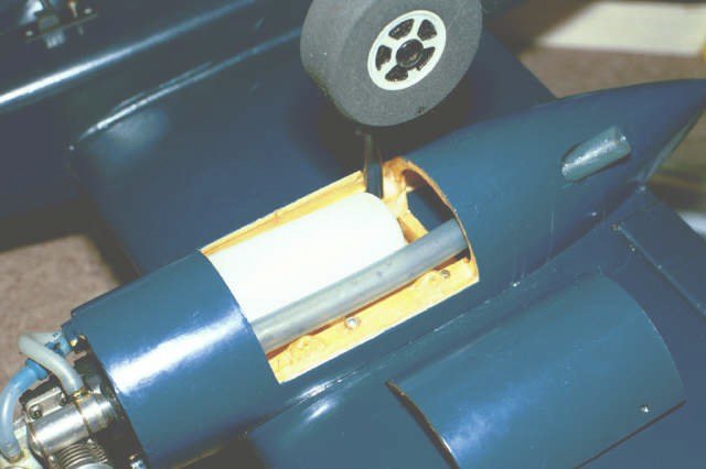

Sometime in the future you might get a second 0.061. Plane in the picture has a pair of AMD 0.061 engines, almost the same as the Norvel engine.
Beforfe you ask, it's scratch built. My own design all the way. and it is the plane in my avatar.

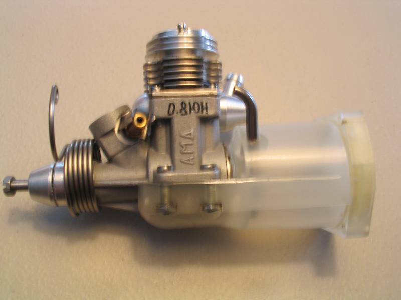

Bill,
Are you sure it's AMD?
Before Revlite, both the Norvel AME and Big Mig looked like that. The Big Mig .049/.061 were switched to Revlite, but (I THINK) the AME stayed with the chrome liner in the small sizes. The "E" in AME is a Russian letter, I believe.
George
George

George:
We've had this discussion before on RCU. The first two letters are definitely "AM," no question. The third letter is the "Almost Delta" of the Cyrillic alphabet, one thing it definitely is not is an "E."
Norvel got the AME from the English translation of the factory name, roughly "Aero Model Engine."
Bill.

Cool plane Bill. Is it modeled after anything in particular? Don't know yet what I will use the norvel on. I just picked up one of the mini ultra sticks and they are super easy to assemble. I got it home at 4:30 and finished assembly at 9:00. It is ready to test fly.

I'm insulted. I took a slight liberty with the scale, butdo you really not see the F7F Tigercat there? It is far enough off that I do call i Tiggerkitty" instead of Tigercat.
Bill.

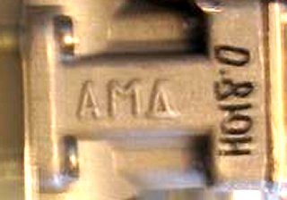

[b]George:
And the AMD (delta) shows clearly in your picture.
The most obvious difference between my pair and current is the muffler outlet - mine go straight to th rear instead of poking out to the side. This did let me run the exhault to the rear of the nacelles, keeping the plane a bit cleaner.
