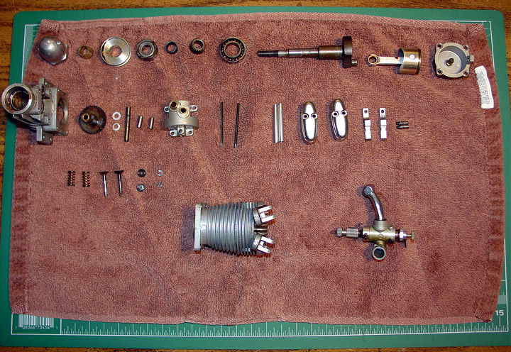

Bone: Here is what a Saito .45 looks like in pieces.

Kmot - thanks for the pic of all the bits. Makes interesting viewing. The discolouration on the cam main gear & crankshaft - is that castor residue or something else ?

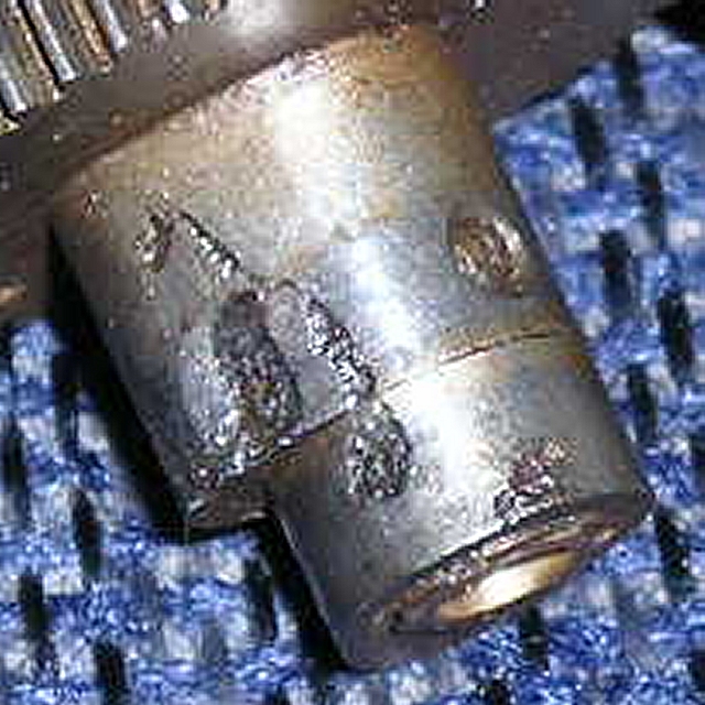

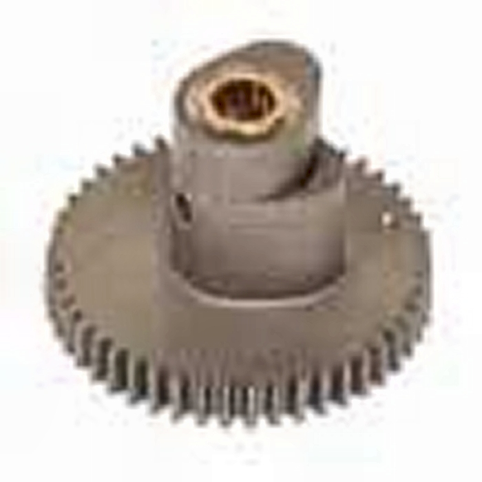

That's the color they come from the factory. Here's a new cam shaft, and two shots showing why you should not run all synthetic oil.
I stuck my nose in because I probably have more failure pictures from Saito engines than anyone else.

That discoloration you see is a combination of dried castor oil and my home brew after run oil. You can also see some on the backside of the drive washer and on the side of the con rod.This engine sat in a baggie after I oiled it, for 14 years or so.

Spit? As Molly said. "'Taint funny, McGee." That third picture is a combination of lubrication failure, hammering from loose valve adjustment, and electrolysis from leaving the acids in the bottom end, acids that would be neutralized with any good after run oil. Including plain old ordinary ATF.

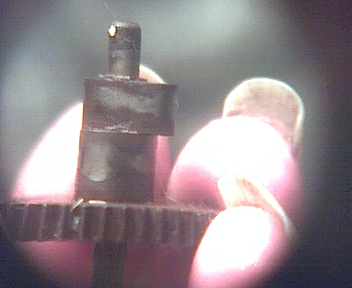

Hello; Seeing that exploded picture reminded me how difficult it can be to get the teflon washers on the cam Idler shaft. Whatever you do, don't leave those washers out, or the cam shaft will ream a brand new hole in your case.
Bill, you got that picture of my cam shaft pretty sharp, sharper then the original. Don't forget to mention that it was in my sea plane, so some of that corrosion might have been sea water.

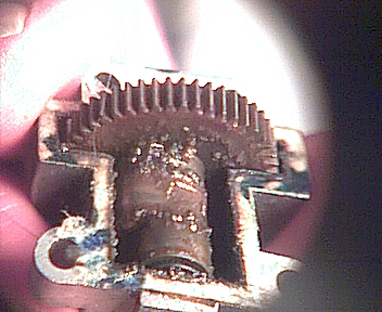

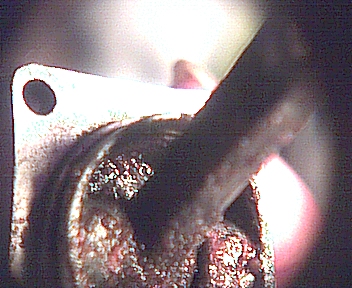

DD:
Forgot that was your cam.
But seawater? I brought an FA-72 back from a salt water death, there was no sign of elecgtrolysis. Here's a picture of the cam in its housing, and another of the bottom of the piston. The only parts needed were a new ring and a set of bearings. Gaskets, of course.
Bill.
